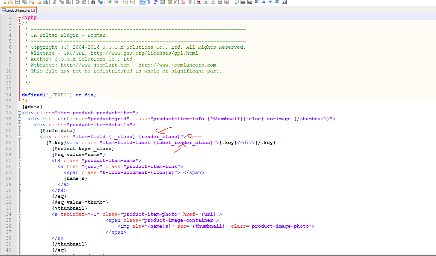

    Where the {render_class} is entered in the field
    Where the {render_class} is entered in the default file:
    plugins/jamegafilter/content/layouts/default/product-item.php

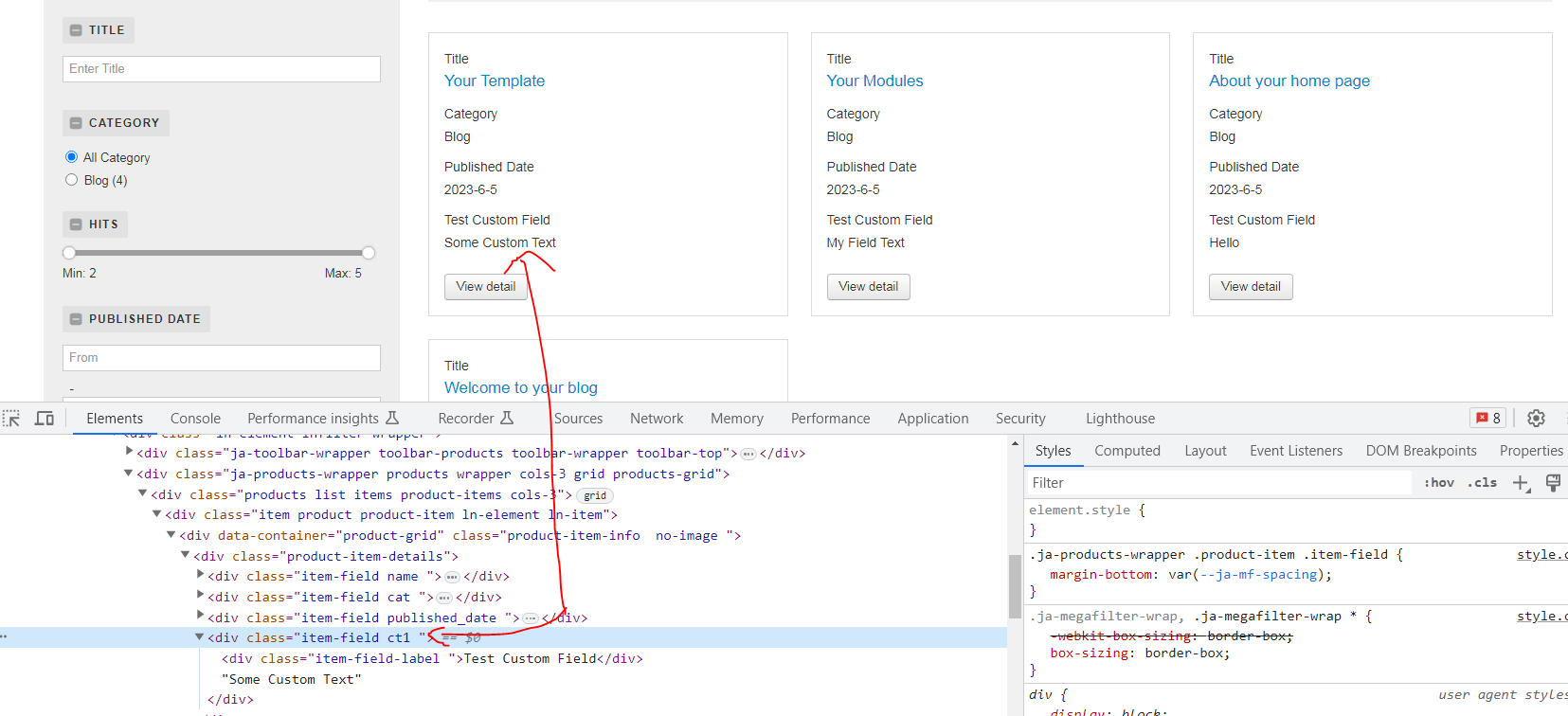

    The result in the frontend (No {render_class} is displayed where it should be)
    It worked correctly on previous versions, but it must have be broken in some newer version.
    Note: It's not just {render_class}, also {label_render_class} also doesn't work
