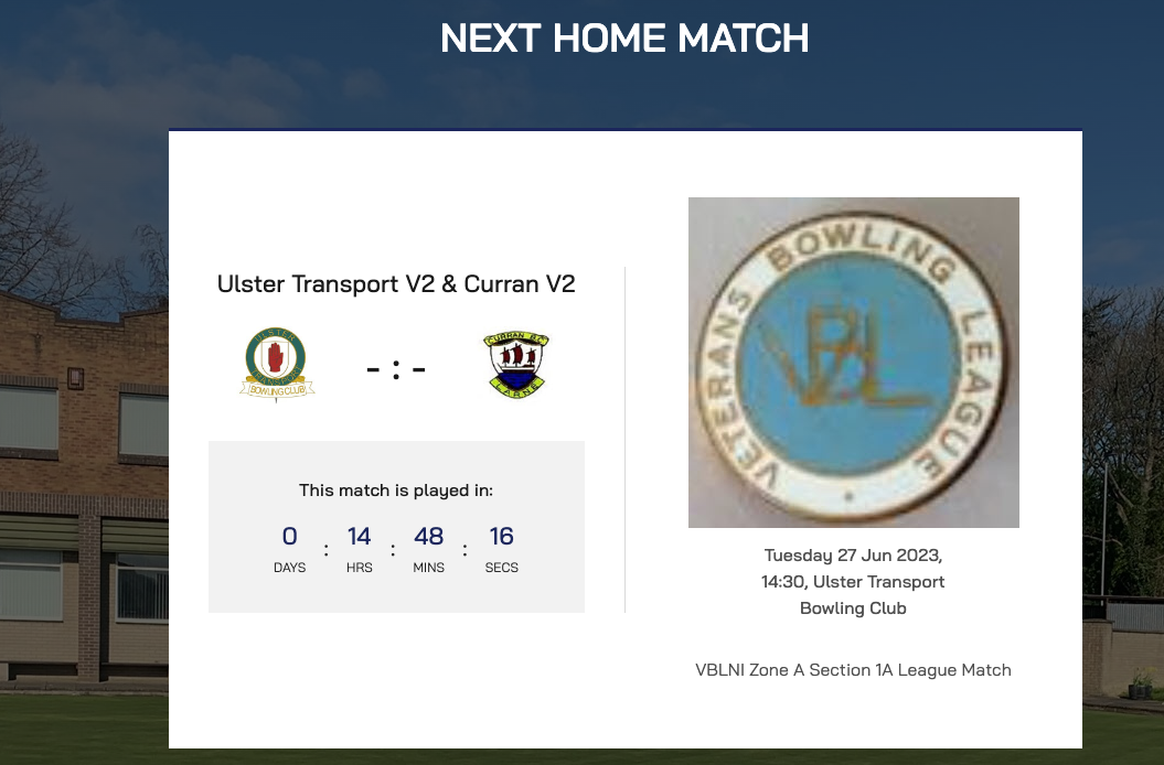

        Yes, the time is now correct but the clock is only going to midnight again.
        The UK time at the image below is Monday 21:30:59pm

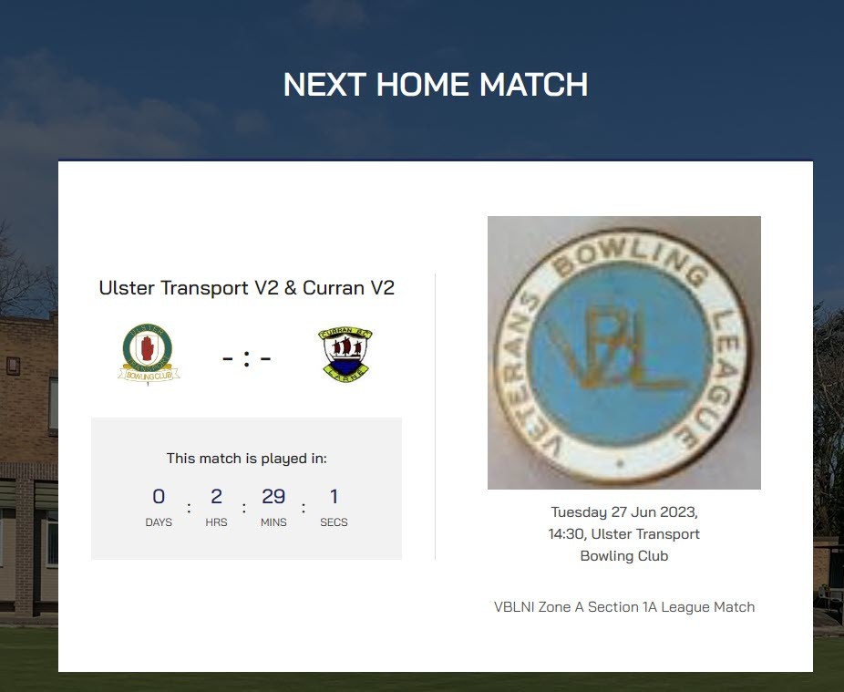

          Yes, I had updated the template to the latest version.
          The countown timer is correct, image below was taken on Tuesday at 11:59:41 (thank you for the fix, appreciated).
          However the time of the match is an hour out ( new match entered as 2023-06-28 18:30:00 in the module and showing Wednesday 28 06 2023 17:30 on the home page).
