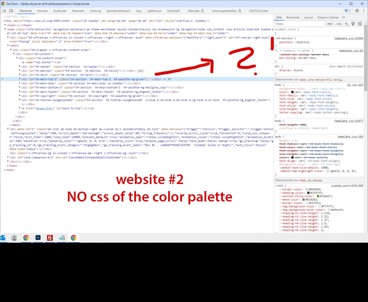

Website #2 has the problem
does not show and does not activate the color-palette of the module positions.

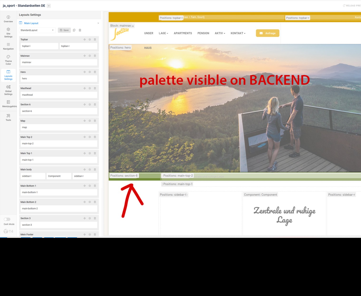

The chosen color-palette is visible in the template area in backend.
But not active on frontend!
CSS of the palette is not visible in the code inspector on frontend.
The color is just white.
Updating Template did not help.
Deleting cache does not help.
(Screenshots show 1 module position as example - but problem exists for all module positions I think. All remain white on frontend)
On Website #1 everything is fine
there is the the color of the chosen palette.
the css code is visible in the code inspector.
So it might have to do with T4 in combination with the Template?
Thank you
Walter
