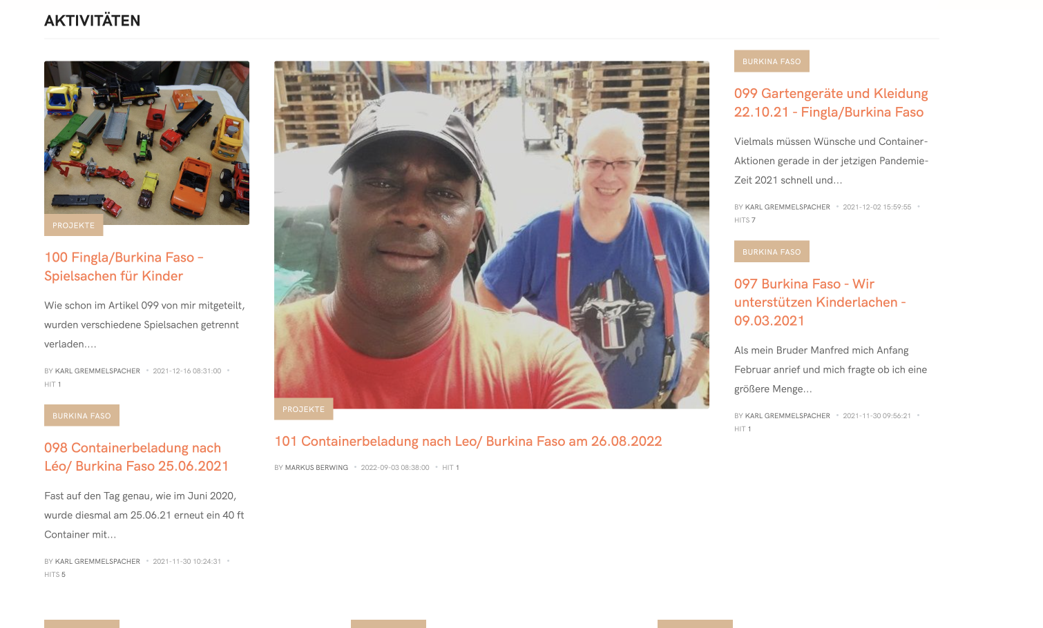

As soon as we create a new manual post in EasyBlog, there are is just the small image icon being displayed on the homepage in JA Content Listing module indicating that the image is not found whereas everything is o.k when we navigate to the EasyBlog post in detail view.
See screenshots.

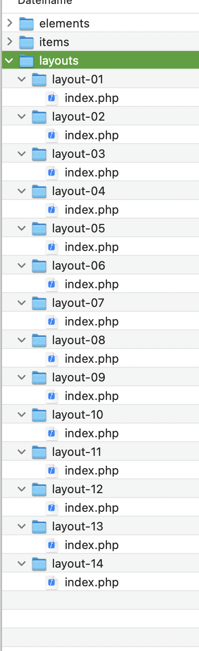

      while I am waiting on your dev team to come back with a solution of the reported issue, I found another issue on your provided version of mod_jacontentlisting in this thread. There were no files in the layouts folder and just index.php.
      So please let your dev team know about this. I have in the meantime copied and pasted the directories with all files from the official version of the module.

        Regarding the second issue: only index.php file in folders /tmpl/layouts/layout-01 and so on. I took a carefully check mod-ja-contentlisting on your current site above and our download site, it still works file with fully files in all folders.
        Would you please give me your other sites, so I can check and help you solve that issue.?

        For the issue that there was only index.php file in folders /tmpl/layouts/layout-01 .....I have manually copied the missing files from official mod jacontentlisting version.
        No idea why they were missing before - and I cannot reproduce the issue since all files are indeed included in the provided module from saguaros two weeks ago. So you can ignore this and it is not an issue.

        I have just uploaded new image for post '098 Containerbeladung nach Léo/ Burkina Faso 25.06.2021' and assigned it to 'Post Cover Image'. So this worked fine for me.
        Please note I have switched from Thumbnail > Use first article image to Post Cover Image on module JA Content Listing on our homepage for testing purposes. The module is named 'Aktivitäten'.
        EasyBlog Posts 099, 100 and 101 have been manually created in EasyBlog and the Post Cover image is visible on module JA Content Listing.
        All other posts ....for example 091 - 098 ....have been migrated by EasyBlog migrator from Joomla posts.
        They also have Post cover images associated when you open them in EasyBlog - but the post cover image is not visible on JA Content Listing on our homepage !
        As stated, your team fixed the issue with Thumbnail > Use first article image ...... but the issue with post cover image still exists
