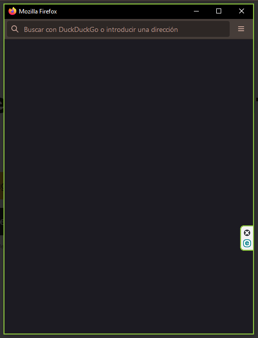

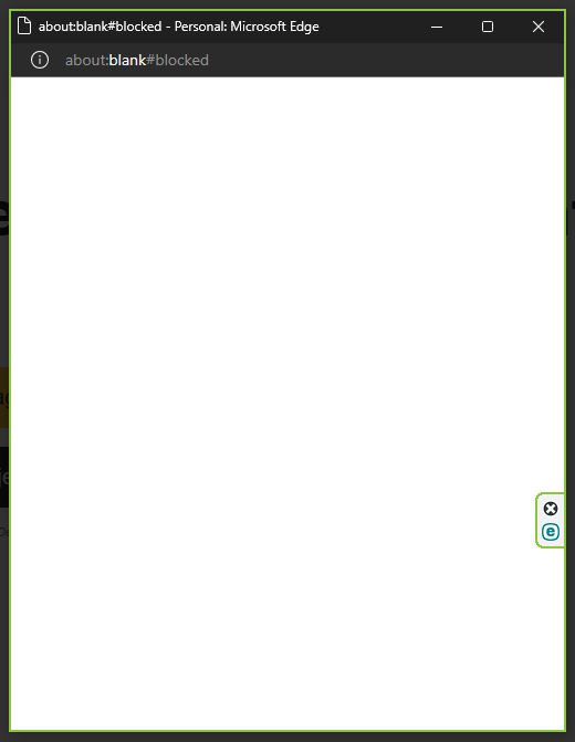

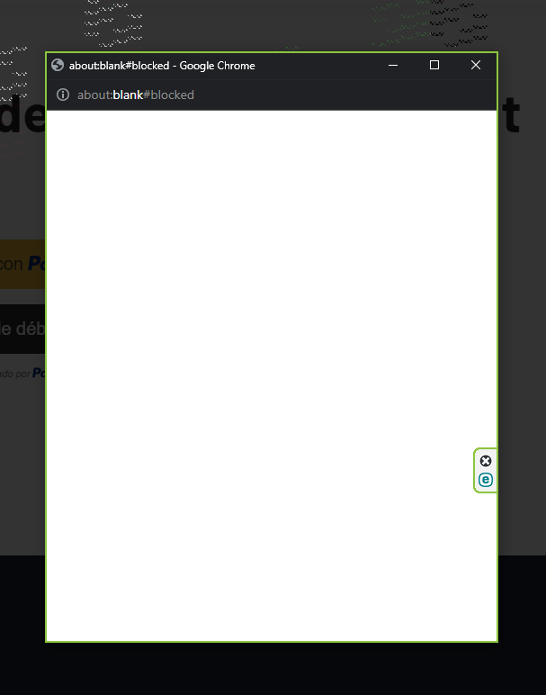

    Below images of the error.

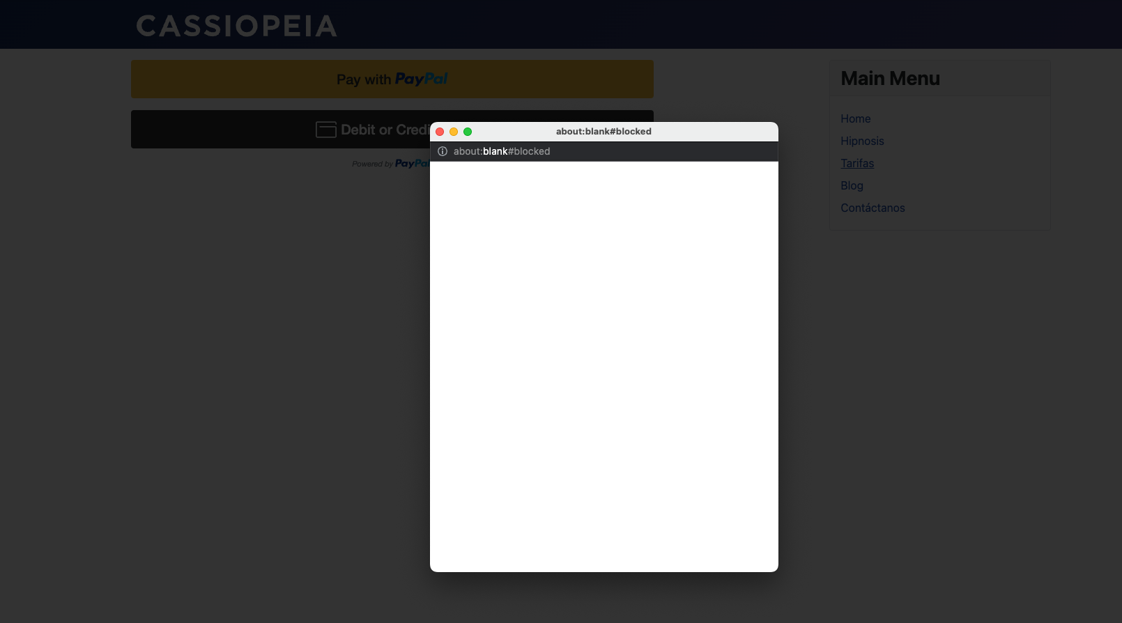

    As with the link (1), I tried to assign that menu item to Cassiopeia template - a standard template of Joomla but the same issue happens there, the blocked popup still displays:
    So I don't think it's issue from template, kindly check the code for this Paypal button again and make sure that it works with default Joomla first.

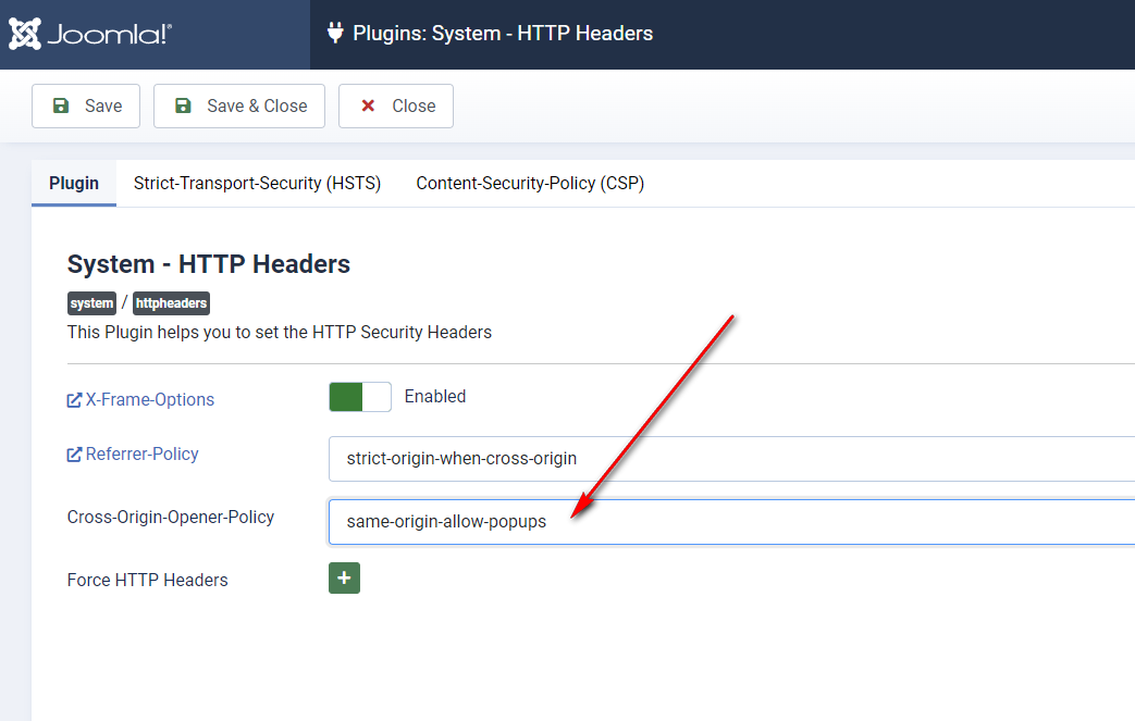

      It appears that the problem was related to Joomla 4, I've just configured the System - HTTP Headers plugin on your site and the paypal button should work now:
      Saguaros, the solution you propose worked well. Thank you so much.
