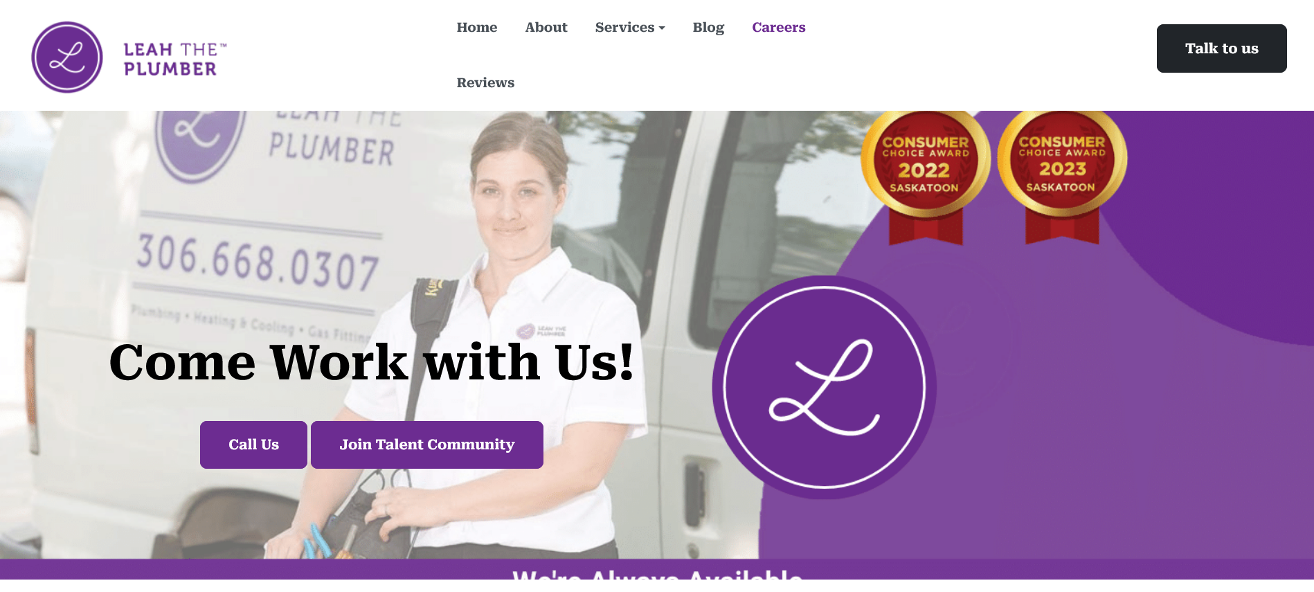

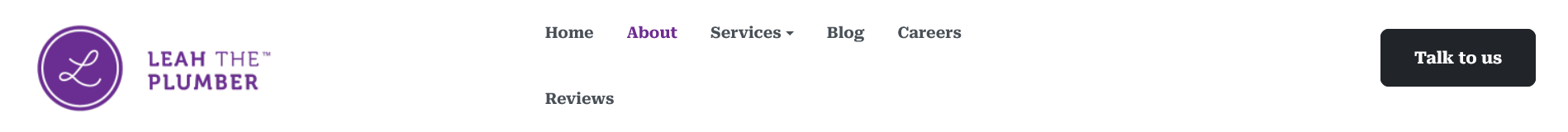

      I would like the menu to be all on 1 line, not 2 lines like it is now. I would Reviews to show up beside Careers and to be able to have room to add more menu items in the same line. I don't need that much room for the Talk to Us button only on the right side and there is not going to be a shop or login area for this website.
        I tested the site in Firefox, Chrome and Microsoft Edge. The menu is on 2 lines in all 3 browsers and I have cleared the cache just in case it pulling from historical data.

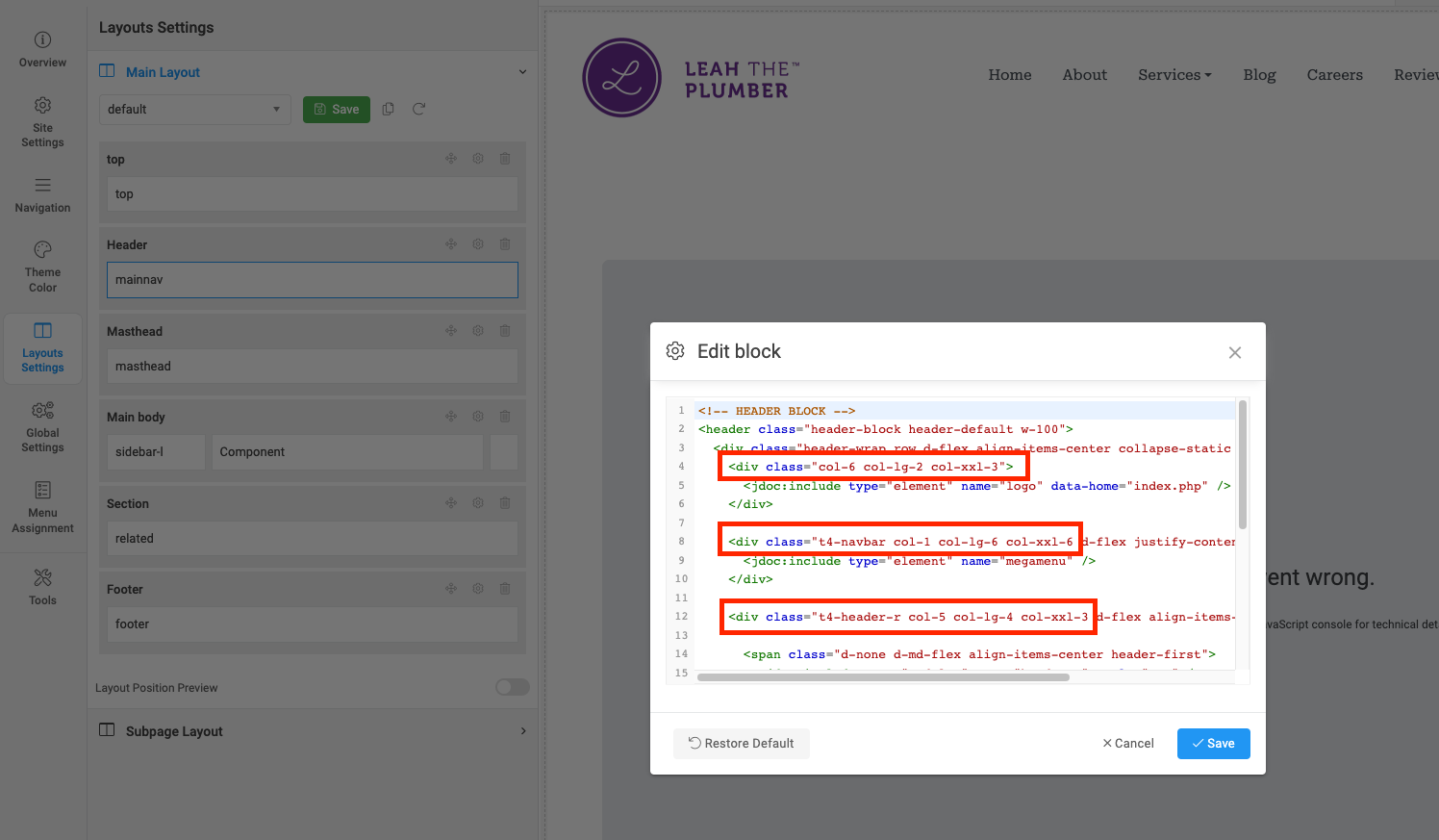

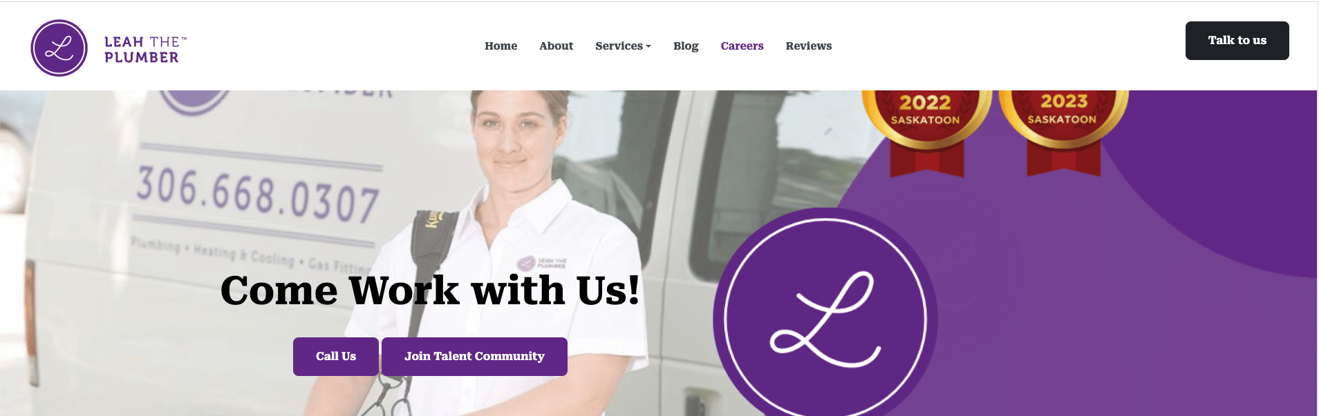

        I can't replicate the same error at my end but I edited the 'mainnav' block on your site a little bit to extend the space of the menu part:
        Could you clear browser's cache and check again?
