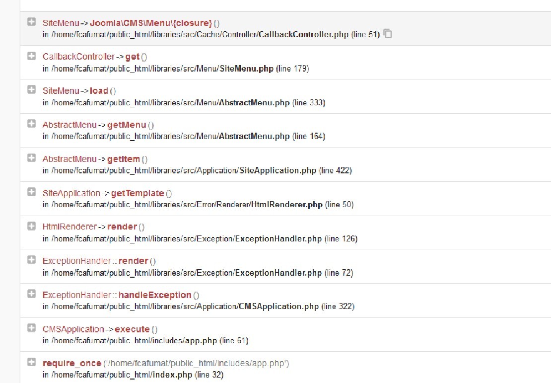

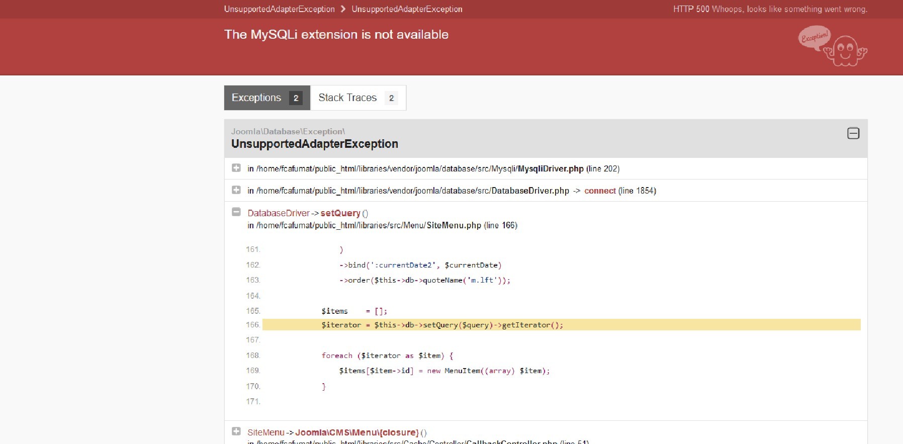

    I set error reporting to maximum and i set php to version 8.2! I receive this error messages!
    It looks like the MySQLi extension is not enabled in PHP. Go the cPanel or a similar page, provided by your host, find the Software section and the PHP version details. Scroll down and tick the box for 'mysqli' to enable the MySQLi extension in the version of PHP the website is using.
    Thank you! I solved the problem in CPanel -> PHP Selector!
