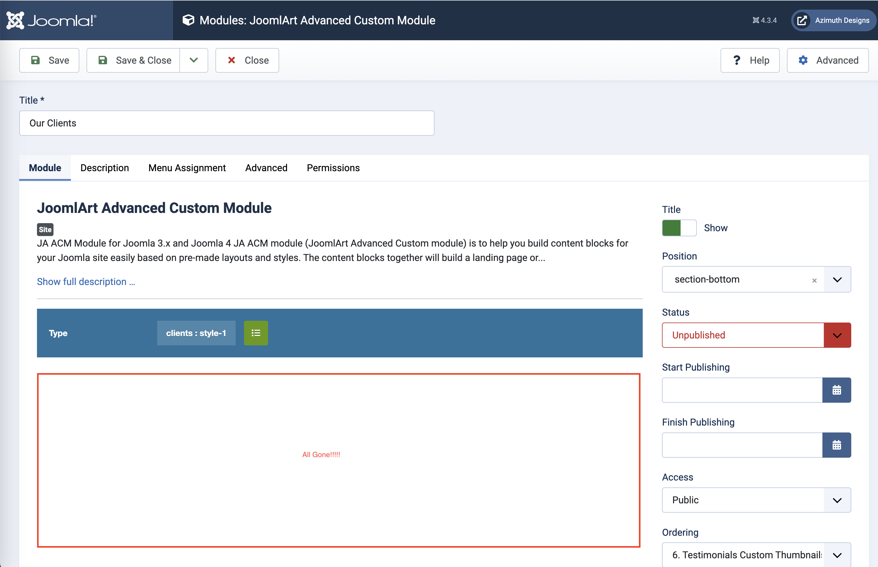

Serious problem created by tech agent installing JA ACM module over my working module.
by updating or what ever you did by installing the JA ACM module you have broken most of my "Modules" and when i turn off/on Modules my entire website breaks.
For example:"Our Clients"
  1. no longer has the Module parameters first page
    https://azimuthdesigns.com/administrator/index.php?option=com_modules&view=module&layout=edit&id=119&client_id=0

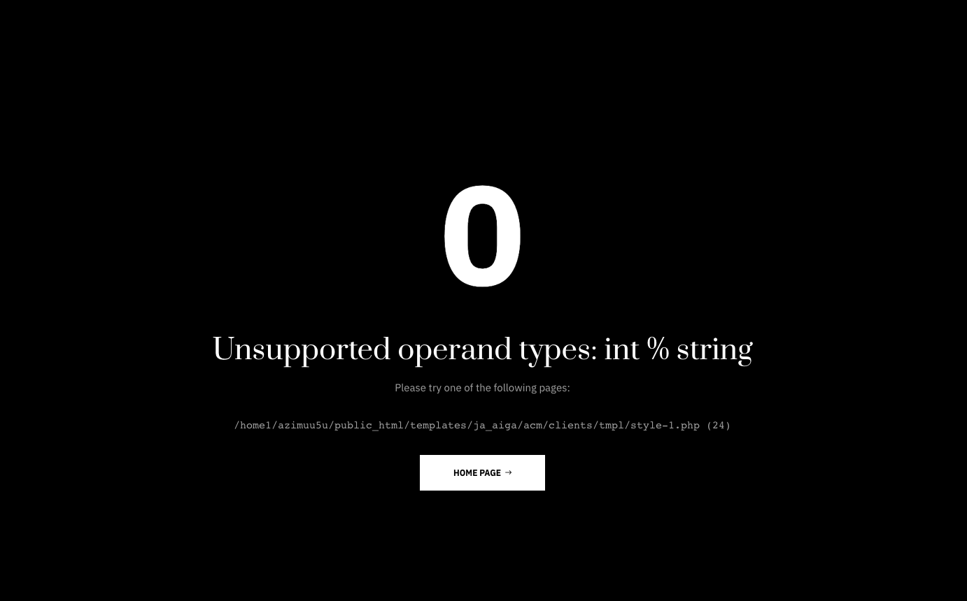

  1. if i Publish it...it breaks my whole website now.
I've still not found a solution.
I cannot make new or edit old modules and publish them because it breaks my whole site.

    Not sure how you update / install this module on your site but as I can see that all types in JA ACM module lacks of config.xml file:
    /templates/ja_aiga/acm/clients/config.xml
    I updated this file for you and it's ok now.
    Kindly check.

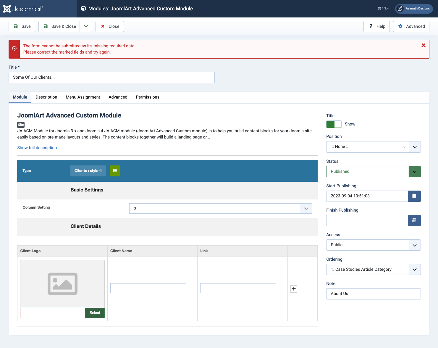

    I can see that some of the modules are starting to work again!
    Unfortunately, they don't have much in the way of a parameter page yet.
    I'm trying to figure out a way that I can refresh the interface with the database, is that possible?
    Otherwise all the information I've added to the modules is gone.
    Thanks!
    Is it possible to that the data is still in the database for these two modules?
    They had also been modified to include the ability to open up in a new window.
