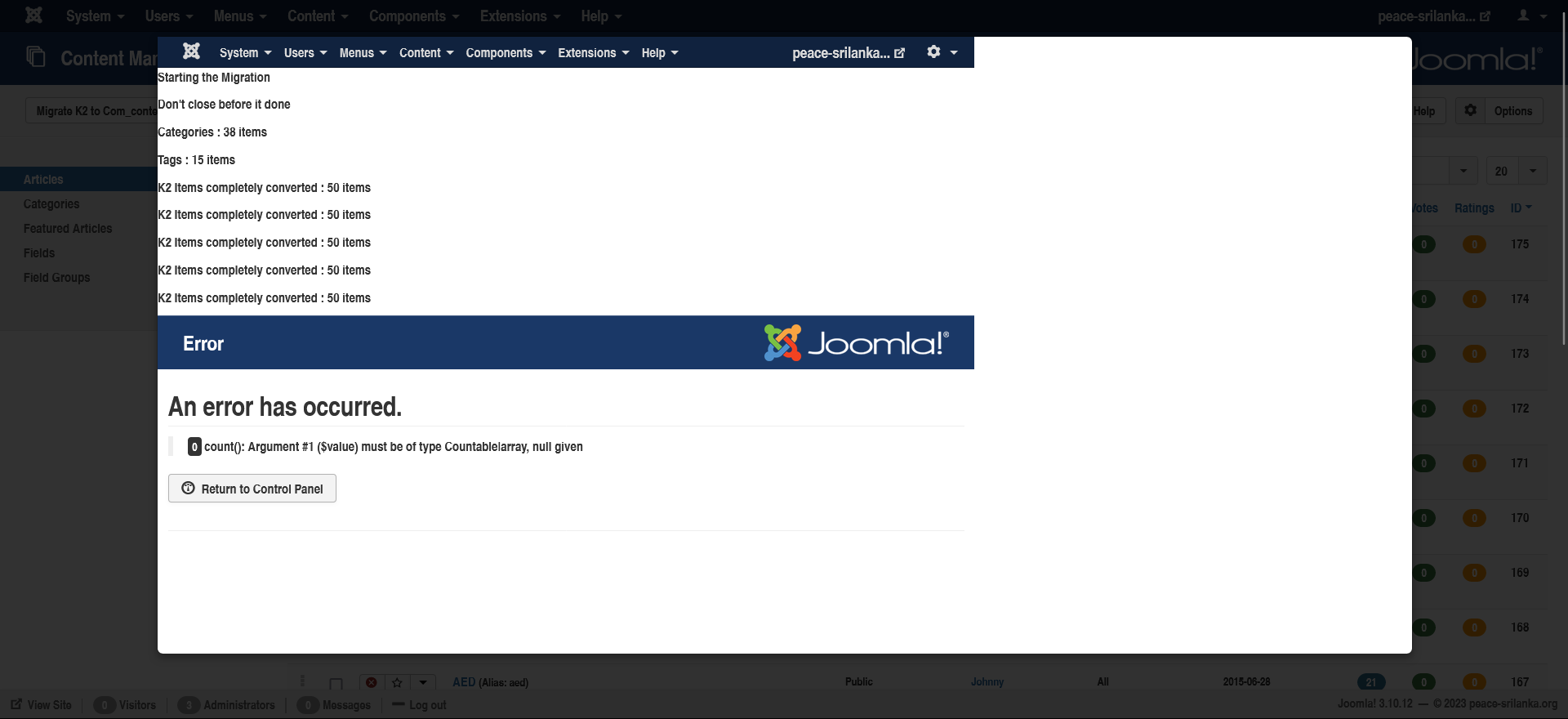

I have an Issue with JA K2 To Com Content Migration. Please check the attached error message. Please advise to fix this issue. many thanks
Rasika
Rasika
It seems to be incompatibility issue with PHP 8 which your site is running with.
Could you take a backup of your site and try with this package?

Hi, hush
After checking and testing with some attempts, I identified some reasons. Your migration from Joomla 3 to Joomla 4 crashed due to some extensions that aren't ready for Joomla 4.
Kindly revert to Joomla 3 version, then check all the extensions to verify which ones are ready on Joomla 4 and which ones aren't. Once this is done, you will be able to migrate from Joomla 3 to 4 safely.
