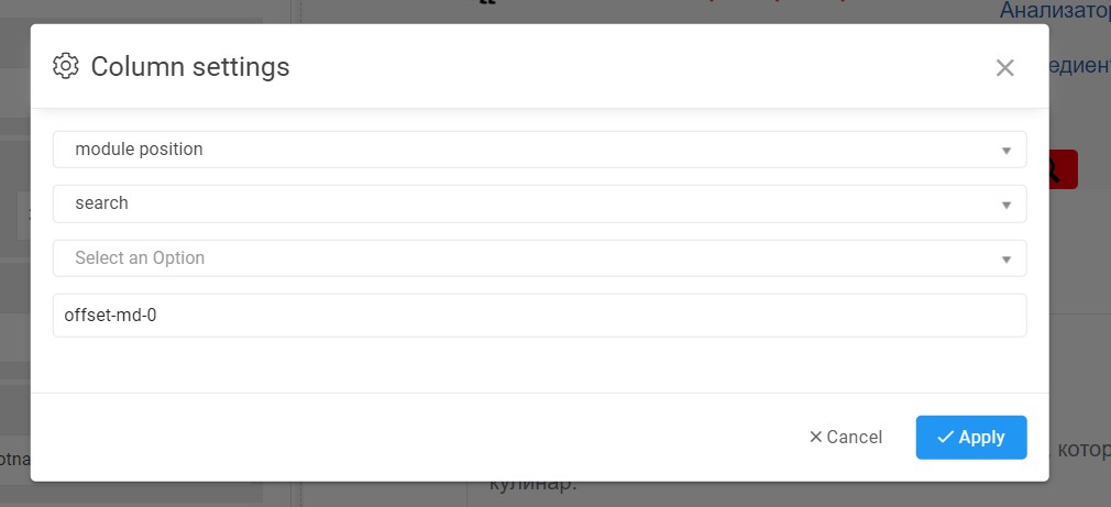

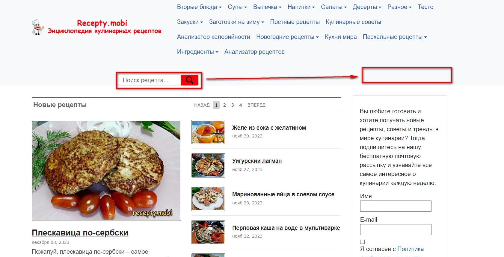

Hello. After updating the framework, the layout has changed. Previously it was:

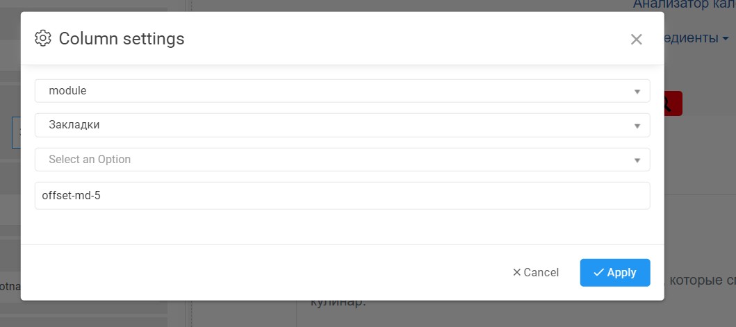

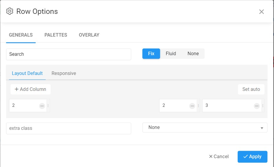

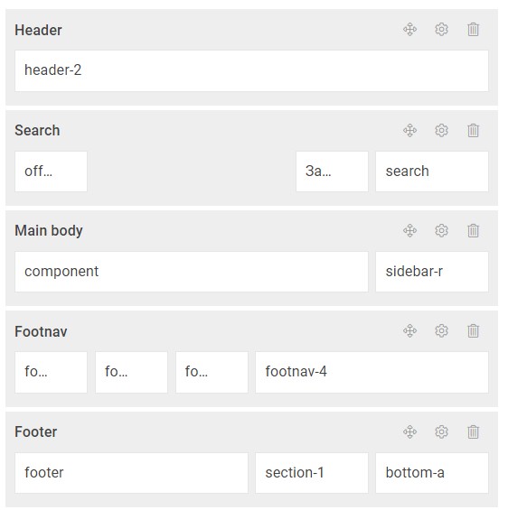

I didn’t change the settings, it is displayed correctly in the layouts, but the position of the search on the desktop version on the site has changed. Here are the style settings:
