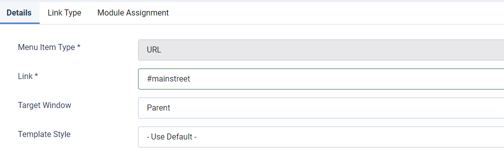

    Let us show you how to add a menu item with an anchor link.
    1. First of all, you have to log into your Joomla Admin Panel and navigate to Content -> Modules (Module Manager). Find the position that you want to show the External link on your site and add an ID for the section.
    2. Then, navigate to Menus > Main menu and add a new menu item.
    3. Choose a URL as the menu item type (under the System Links).
    4. In the Link field, you have to add the # symbol and then the desired module position name. It will look like #mainstreet in our case.
    Hope this helps!
