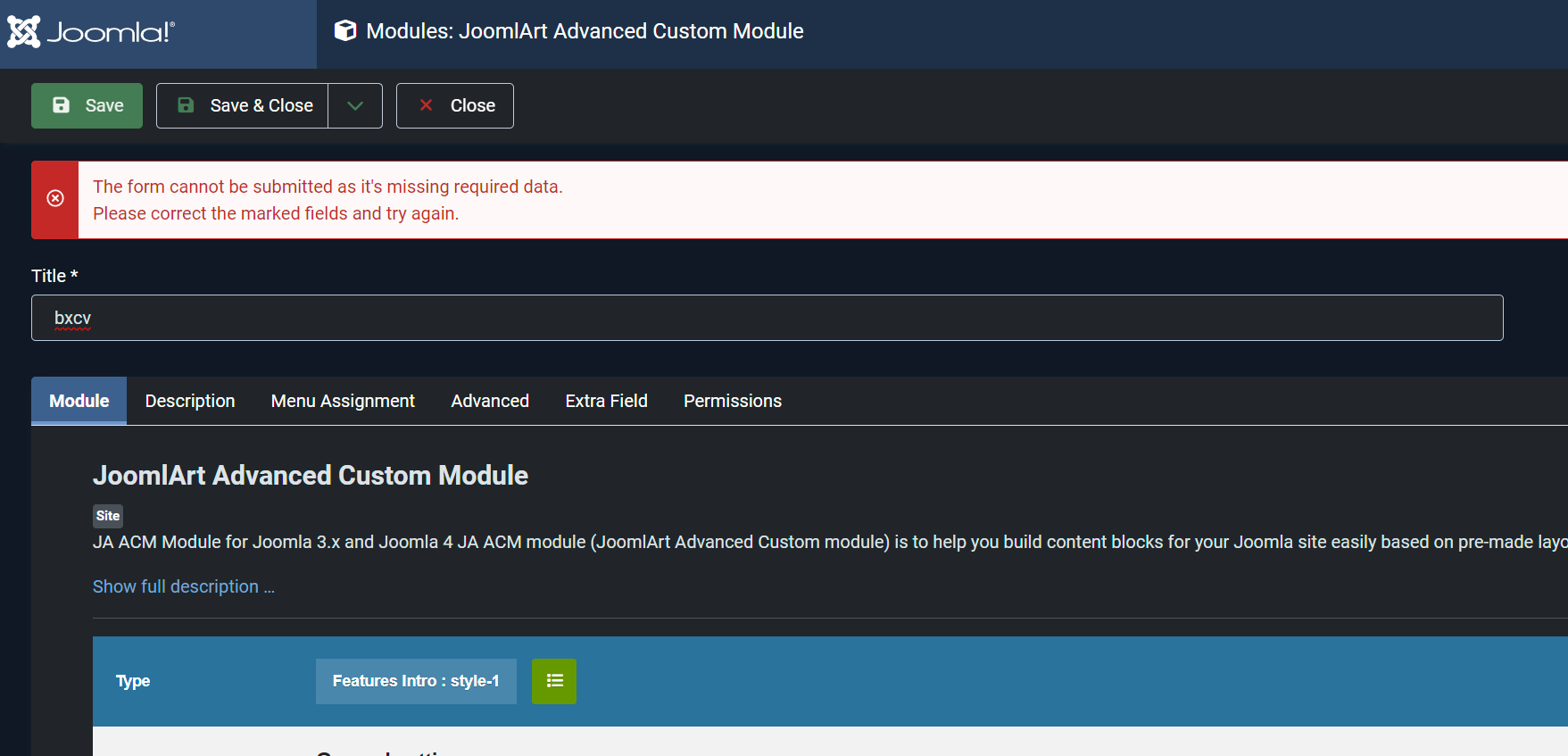

I tried to save Featured module for style 1 as per docs but getting the above error
ACM Module can not be saved for style 1

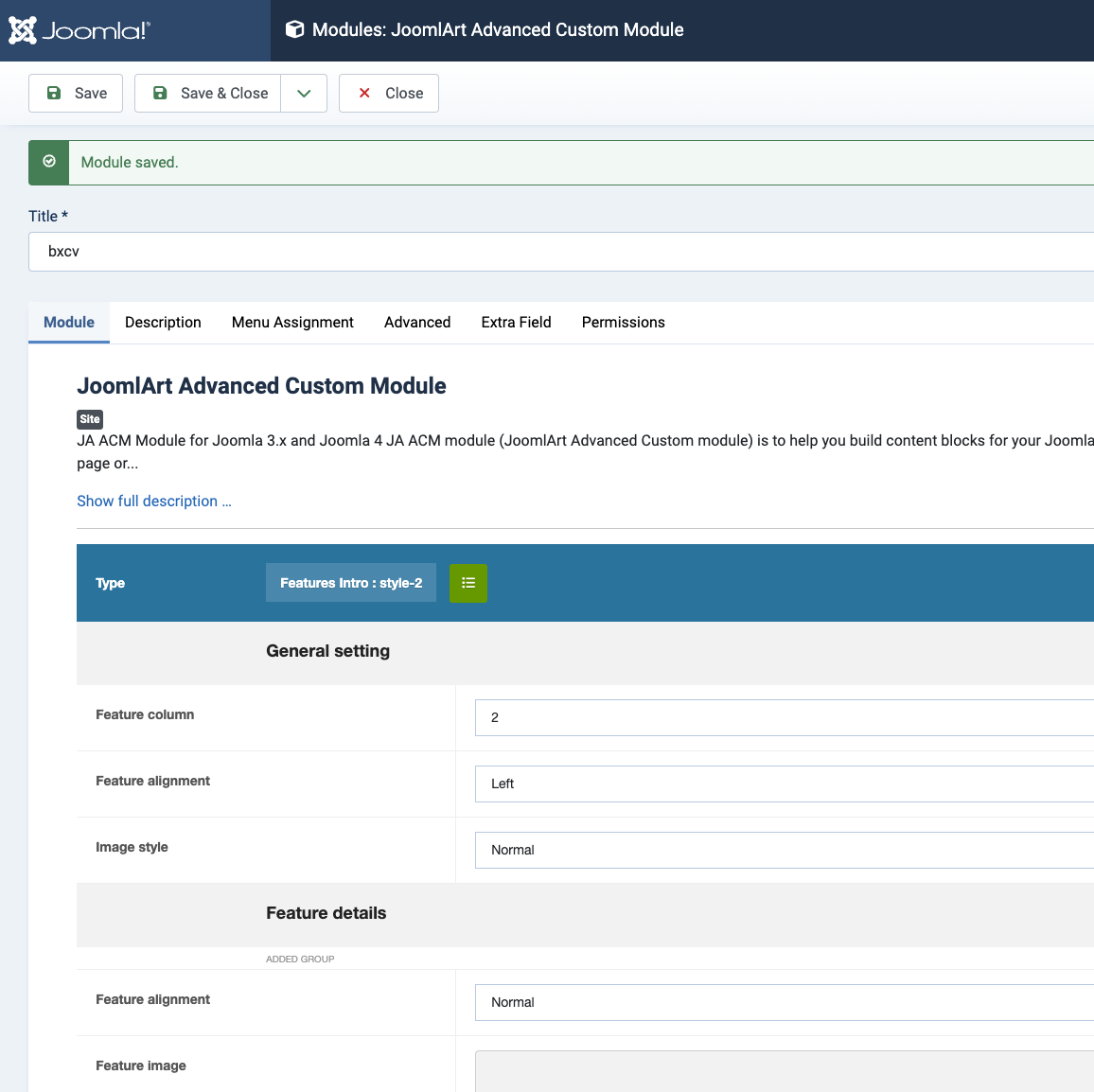

I can see the successful message when trying to save this module on your site, did you manage to get it solved?
saguaros This is style - 2. Style -1 still have an issue
sachinsehdev It looks like the image field is required in style-1, could you add this field first?
If you don't use this field, open the file: /templates/ja_nova/acm/features-intro/tmpl/style-1.xml
and remove this line of code - line 43:
<item name="intro" type="media" default="" label="FEATURES_INTRO_IMAGES_LABEL" description="FEATURES_INTRO_IMAGES_DESC"/>
saguaros Great, THanks; I will use these fields with no issues. Just feedback to put asterisk sign-on mandatory labels or display a meaningful error message so that we do not have to wonder what is required.
I really appreciate your help and support,
Thanks so much !
