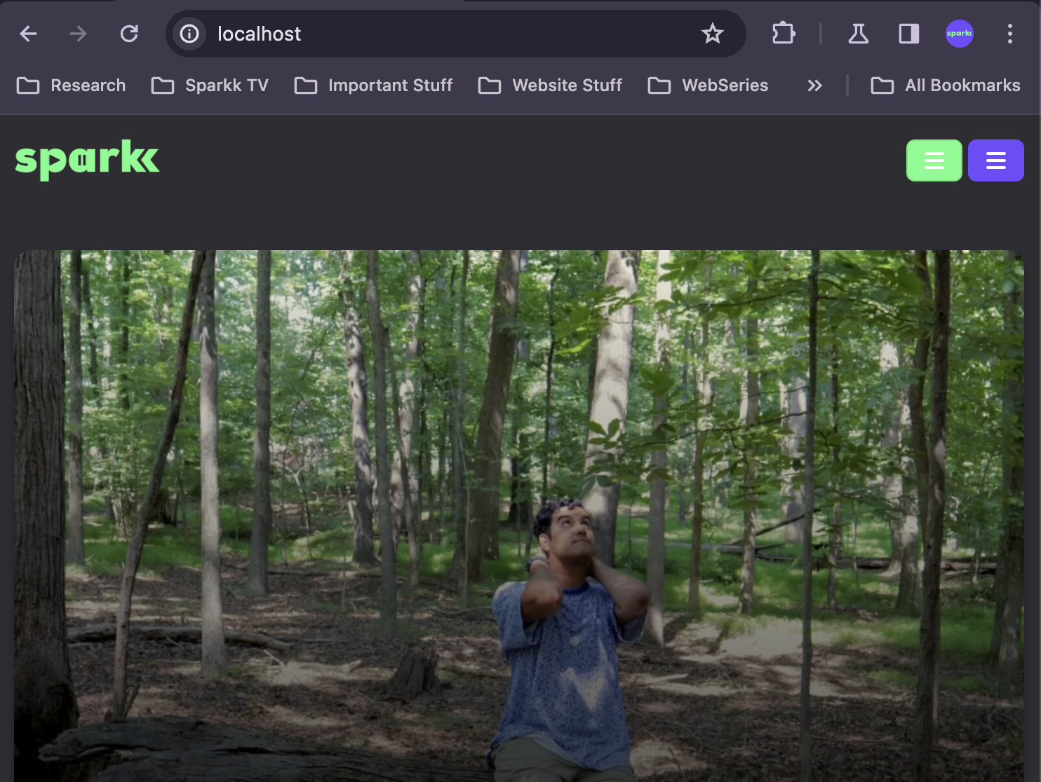

    And here is a picture (since I'm running in localhost) of the issue with the off-canvas menu. It stays on always despite being disabled in the template settings. And shows 2 of them on mobile. And only the purple one that shows all the time works.

      Hi carlosdel123,
      In this case, you can use the following CSS code to hide the button:
      .gk-offcanvas-wrapper .btn.btn-primary {
        display: none;
      We will update this feature in the next version.

          2/ I'm currently puzzled by the off-canvas issue. To remove the icon, you'll need to disable the corresponding option across all template styles. My apologies for any inconvenience this may cause.
