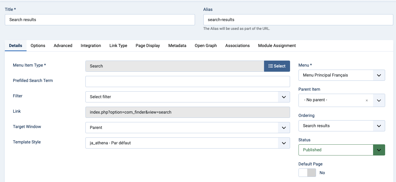

You're right, you should create a menu item type of Smart Search >> Search so it can return the result in correct page.
I just created a sample menu for this type and it worked:
