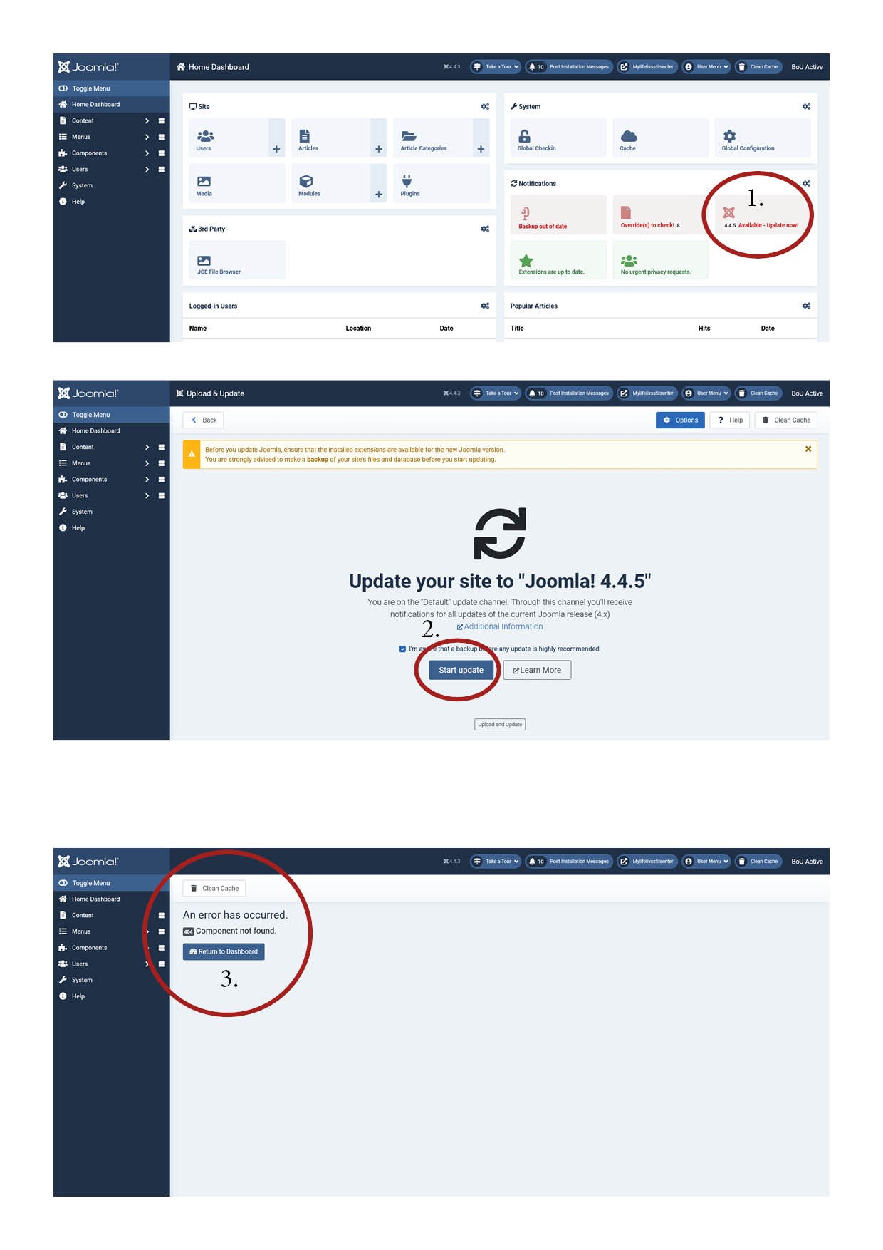

Can't update to Joomla 4.4.5

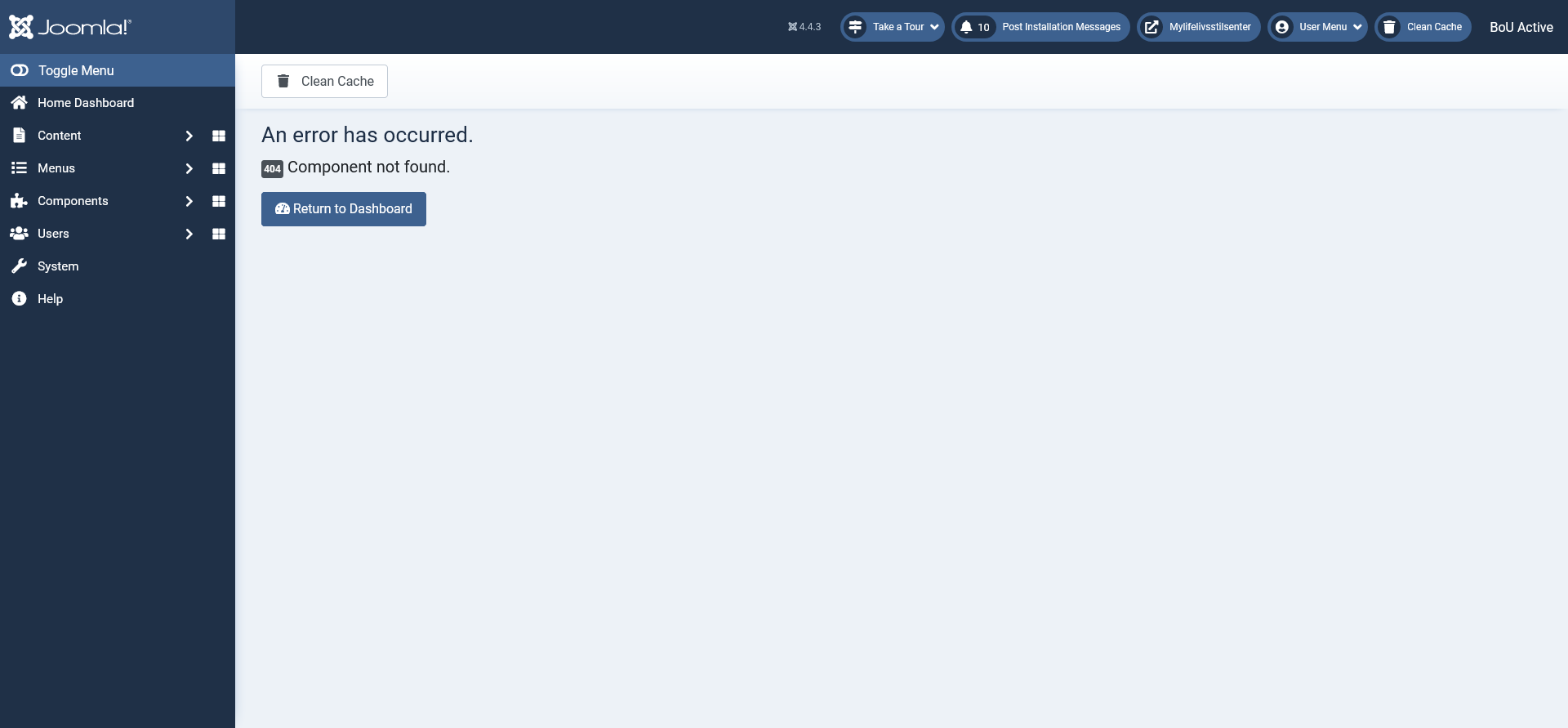

It give me this error: An error has occurred. 404 Component not found.
I have not been able to update Joomla since 4.4.3
I have several other sites with the same template on the same server and they are ok.
Error when update Joomla
norwegian69 I don't see the issue in backend of your site now, could you clarify steps by steps so I can replicate it?
I click the button to update Joomla, follow the instructions and get the error message. (I have a backup)
See attached explanation

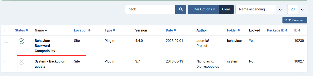

Hi, norwegian69
I have conducted tests and identified that the error was caused by the Akeeba plugin: System - Backup on Update
. Please disable this plugin and proceed with updating Joomla core, and your site will then be running the latest Joomla version.
Regards,
Wow you are good!
Thank yo so much
