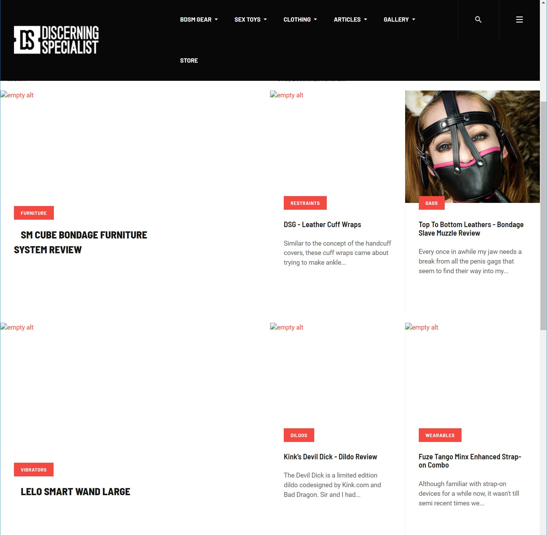

I recently attempted to update my site to the latest joomla 4x and flix to 2.1.1, however ran into an older issue where my intro images defaulted to not being able to display. I'll guess a similar issue from:
https://www.joomlart.com/forums/d/38636-empty-alt-error-images-on-update-to-flix-2-0/6
Where if I set any intro images using:
<img src="/img/gallery/fashion/leather-DSC0052-adj1.jpg" alt="empty alt">
type format they will not show, but removing the initial "/" will work, such as:
The main menu navigation is also not acting correctly to responsive sizes and easy to generally cause inconsistent behavior while hovering over different parts of the menu. Oddly my dev install with same joomla 4x and flix 2.1.1 seems to not have these issues, so I'm not sure what files are causing the issues and could use some help.
(NOTE for now I have reverted back to an older flix version so my live site isn't as much of a mess)
https://discerningspecialist.com/dev1/

      Hello
      I checked your /dev1/ site and it's using JA Flix 2.1.1 version but all images are showing fine now.
      Is that working now on your side too?

        saguaros Sorry just seeing this reply, I'd say a summary of the current situation is the dev1 install is working as expected, but for some reason the live / root install was running into issues trying to update to the latest Flix. As a result I had to revert back to an earlier version of Flix since live. As I was saying I wasn't sure if there are some other files that would be causing these differences or if perhaps need to find a way to completely clear my root flix install and start fresh.
