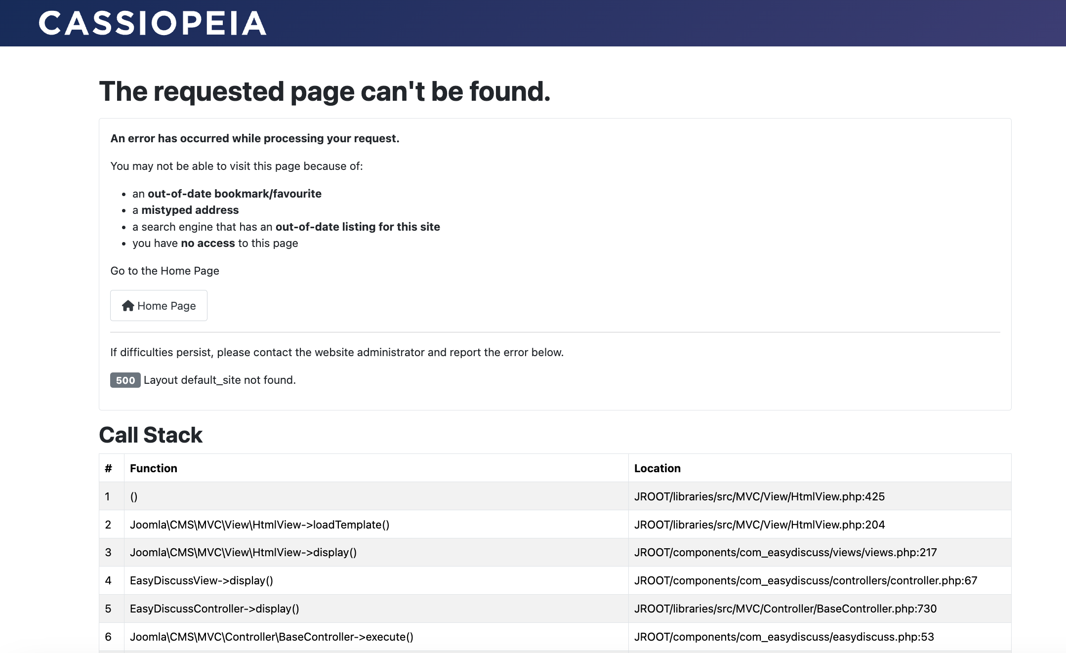

/index.php/chat/all/latest?format=ajax&tmpl=component&category=6&start=5
500
Layout default_site not found.
/home/zisyjudx/veganscircle.com/administrator/cache/t4core/HtmlView.php (425)
An error has occurred while processing your request.

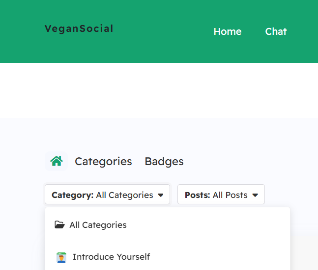

Click Chat on the main menu > then where it says all categories> click the dropdown selector menu and click introduce yourself>

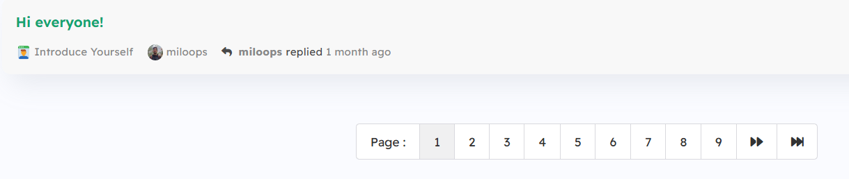

then click any of the pagination menus at the bottom of the page and you will see the url for example is /index.php/chat/all/latest?format=ajax&tmpl=component&category=6&start=5

Yes, I can reproduce the issue using these steps. It appears to occur in the category view of EasyDiscuss.

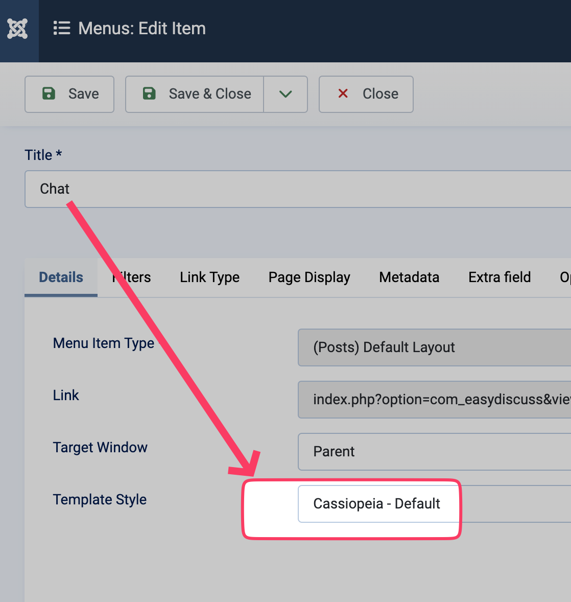

I also conducted a test by assigning the Chat menu item to Cassiopeia, which is the default template for Joomla. However, the same issue persists.
Could you please contact StackIdeas support? This issue pertains to EasyDiscuss itself.
