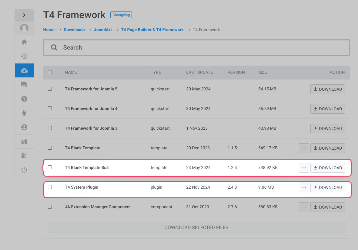

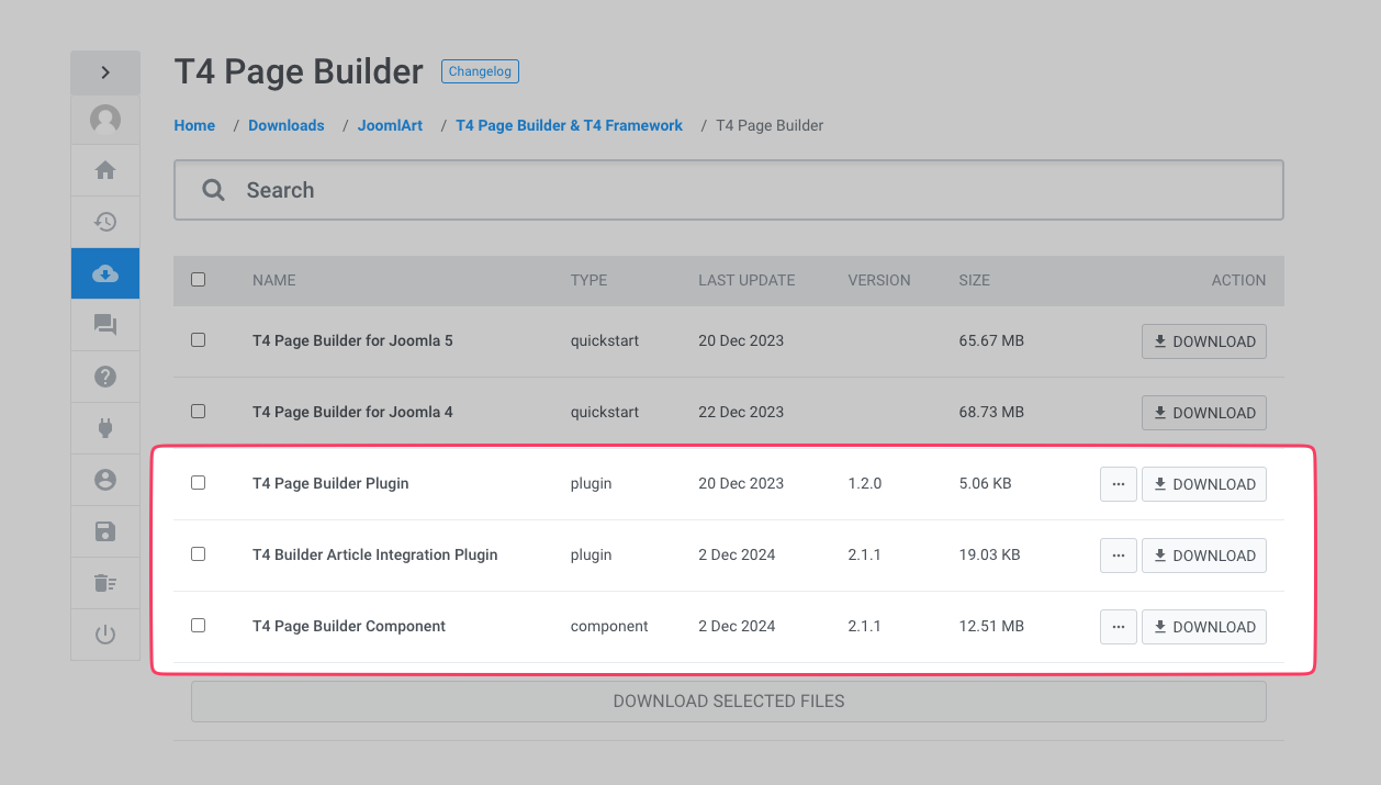

    calebsc Hello
    It looks like you're trying to install Quickstart package into an existing Joomla website. Each of our template comes with this Quickstart package but it's used for a new website only (it's the same with Joomla package but including the sample data as our demo site).
    If you have an existing Joomla site, you should try this:
    T4 Page Builder
    https://www.joomlart.com/member/downloads/joomlart/t4/t4-page-builder
    Download these 3 packages and install one by one via administrator panel of your site
    T4 framework
    https://www.joomlart.com/member/downloads/joomlart/t4/t4-framework
    This T4 framework is not required if you're using T4 Page Builder, you will need to install this only if you're using T4 Blank BS5 template or other JoomlArt templates.
    You need to download plugin and template package and install the same into your site.
