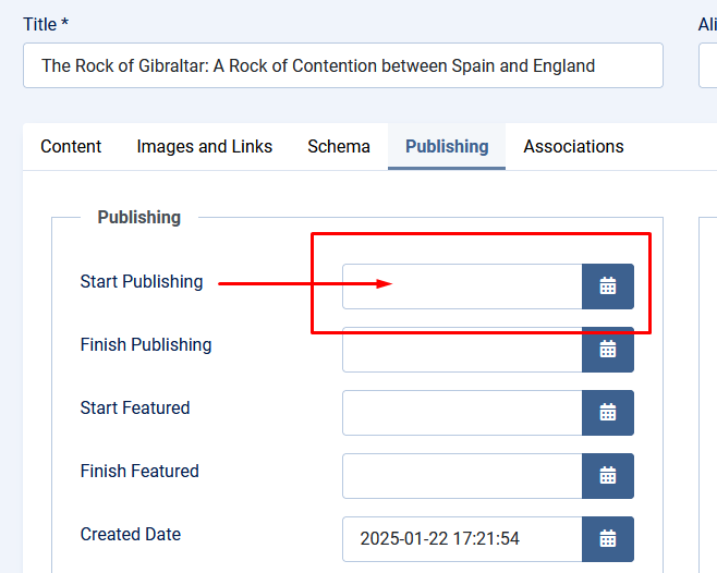

Have been using JA Multilingual successfully for over a year.
Just updated JA Multiligual:
It leaves START PUBLISHING date empty on newly translated jom_content.
Thus, throwing a 404 error.
Is it a bug?
Would someone confirm?

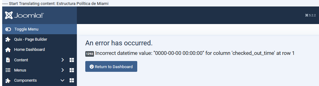

Hello there? Anyone else reporting issues with the updated JA Multilingual on J4?
In our case, the publishing down date is being completed with 0000-00-00 00:00:00 instead of NULL.
We are modifying the script to complete the the date correctly.
I can replicate the null start / finish publishing date but not the 404 error. I've reported to our dev team to take a look.
Will keep you posted.
