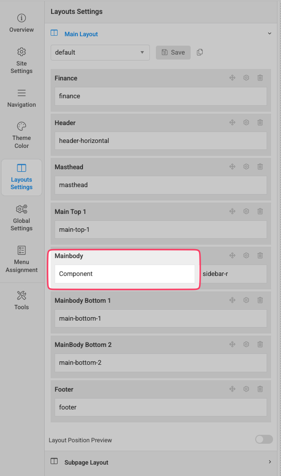

    From the frontend of this blog page, I guess the template style you're assigning to this menu item doesn't include the component block - the main block which displays main content of a page.
    There are 2 approaches here: Backend >> Site template styles >> JA Purity IV >> layout settings
    1/ Switch the current layout to default layout
    2/ Edit the current layout by adding a new section + load the component block there as my above printscreen.
    Hope this helps.

    Thank you! It's possible to have only the "component" without sidebar?
      sicurarmor Yes, you can simply click the settings icon of this Mainbody section and remove the column you want.

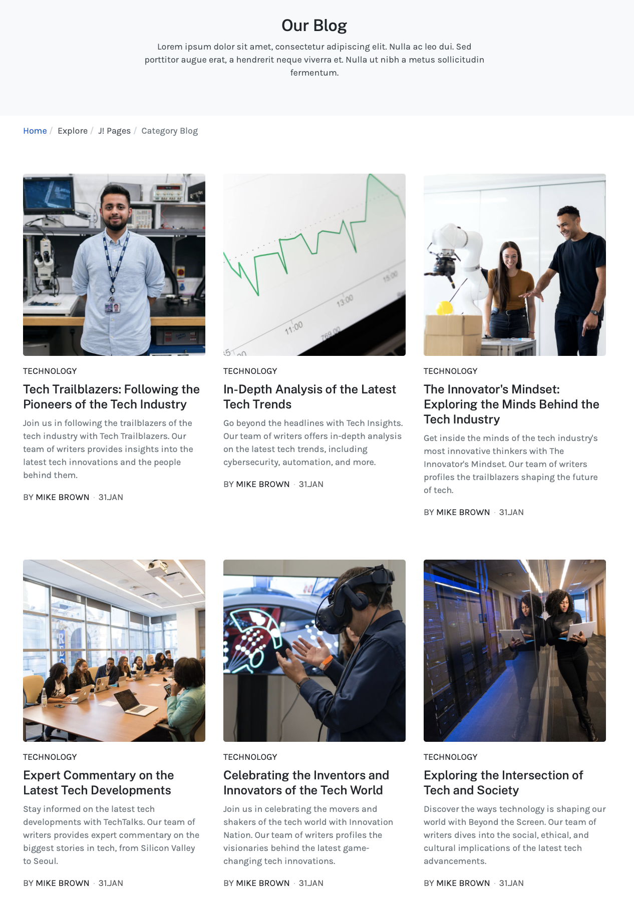

      Thanks, now blog is visible. But like a list, I would create the effect in demo
      How? I'm going crazy...

        norwegian69 id set “list of category blog” . So I don’t know the visualisation is not the same. Also the single article, the photo is at the bottom of the article…

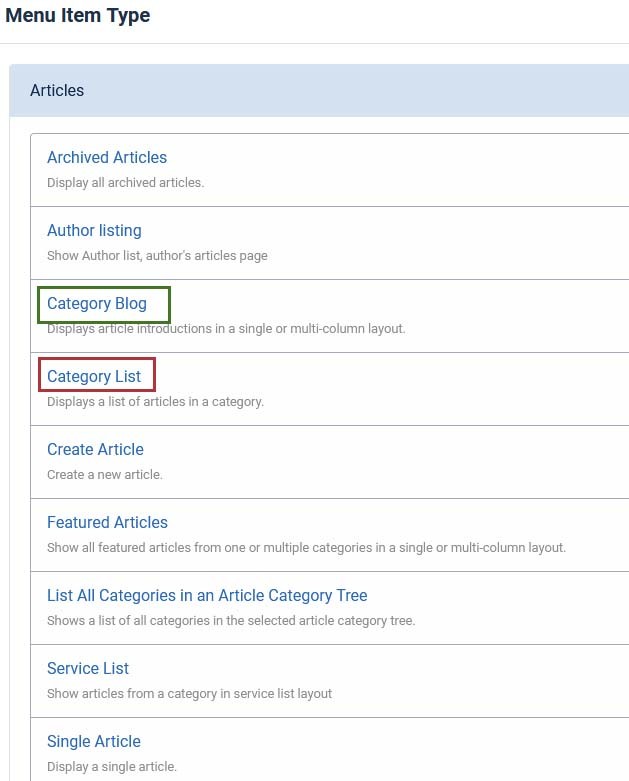

          sicurarmor Hi,
          I'm just a regular member like you, and I don't have the opportunity to see what settings you use in the menu item.
          But you wrote in your first post that you used a category list in the menu.
          That's why I thought you should use a Category Blog instead of a Category List, so that it would be similar to the demo site. 🙂
          2 menu items, Blog and Podcast, are set in List of Category. The template style is configured for both of items. I don't know.
