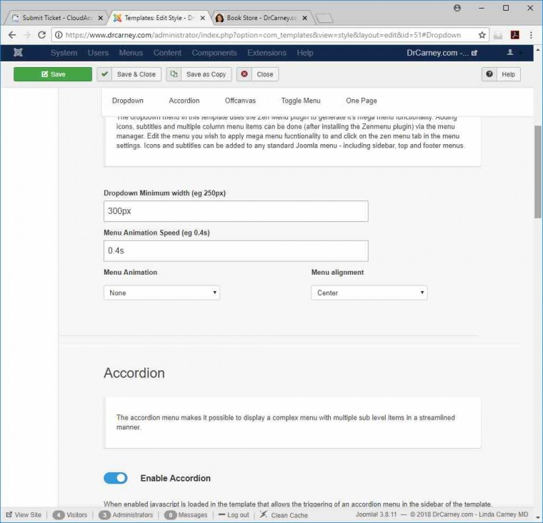

          paulus1031 Yes, the style seems to be having a TON of problems for me right now. Actually the main thing is that a bit earlier I set the minimum width of the template to 200 pixels and I compiled the template css after @aman204 added his suggestion to align the menus to the left.
          I have since changed the menu minimum width to 300 and have commented out the CSS alignment changes. So, I am expecting the changes to be visible but I am not seeing them. It is certainly baffling me! :-(
          I wonder if I am running a wrong version of the framework? I am using version 5.1.6 of plg_ajax_zengridframework with the Colourshift2 Buildr template.
          I have turned off the cache in global configuration, the system cache plugin is not enabled, I have disabled my cdn plugin to keycdn, and I have removed all history from my browser, but still I am seeing the menus at a width of 200 pixels and my menus alignment on the left side. Both things I am trying to have go away. I have compiled less and have saved my 'changes' to template multiple times.

          The menu settings are displayed below but this is NOT what is actually happening.

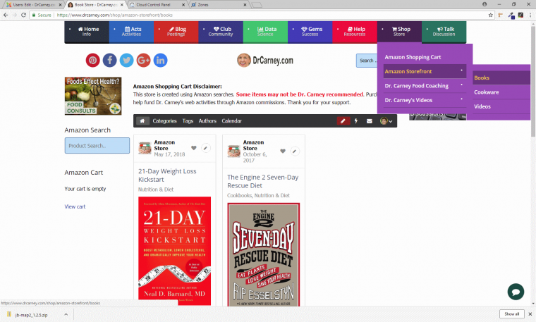

            Also, What is not displaying properly now is the child and grandchild menus under the Shop menu. In the picture that I am attaching you will see that there are no menus visible under the Books submenu. But, there should be. They are hidden off screen. In order to see them you need to stretch your browser wide across multiple monitors. This will only work if you have a mutil monitor set up.
