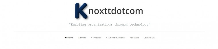

This is how it looks now:
It's not centred, and you can't see anything. This is how it's supposed to look.

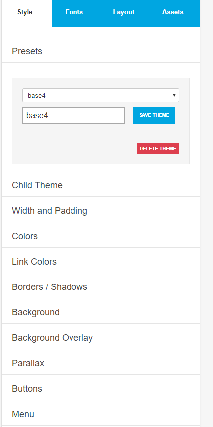

If you feeld confident with duplicating some files you could just work in one template to get the settings as you want them and then follow the instructions here
https://www.joomlabamboo.com/blog/how-to-joomla/how-to-duplicate-a-template-style

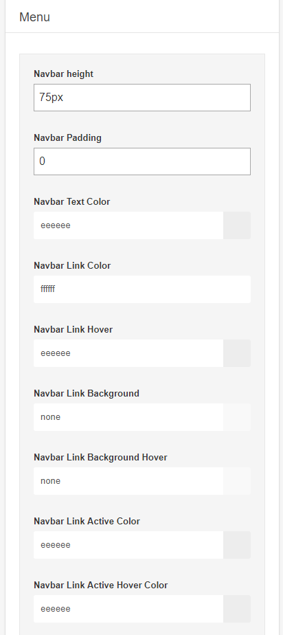

This is my menu settings for the container and it doesn't show.
I fixed the fonts but it's still aligned right and the top and bottom border still doesn't show.

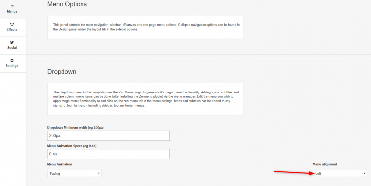

menu alignment
I had 0 px . Just saw that. So the only issue is the right align. I want it centered.

Okay things look good. I'm gonna have to check out that link you posted cause to change the menu fonts I went to the default and to align the menu center I had to go to the template for the home page only. Really confusing.
Yes it is different that for example T3 where settings are linked across template styles - for zengrid / buildr you need to enter them
