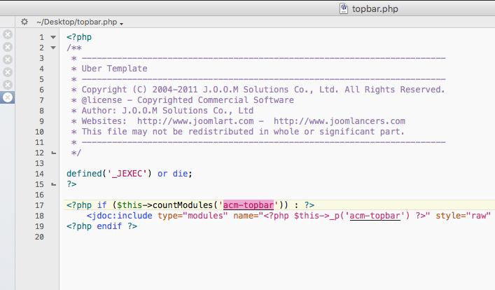

I have tried to add an additional Block above my Main-nav ‘Menu’ so I can have a contact number etc.
But I have followed the instructions provided by ‘charles99‘ in this post: link and I’ve also tried both top-bar and topbar files from the Healthcare & Uber template and neither are working.

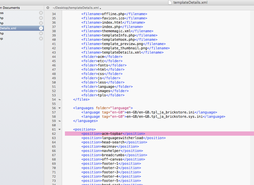

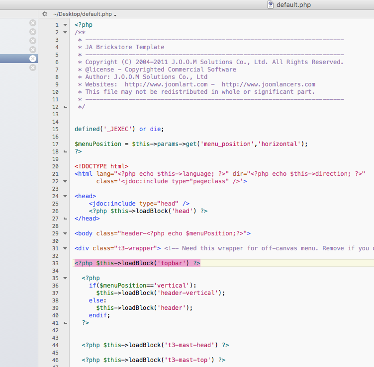

I have also added the additional lines below, to to both the default.php & templateDetails inside my templates folder – see attached screenshots of files and nothing seems to be working!!
<?php $this->loadBlock(‘topbar’) ?>
acm-topbar
Please help!

February 6, 2018 at 2:50 am #1090242Hi,
Did you try to load that topbar block into this layout? root/templates/ja_brickstore/tpls/fullwidth.php
Or share me the credentials of your site: URL, Admin + FTP account so I can check for you.

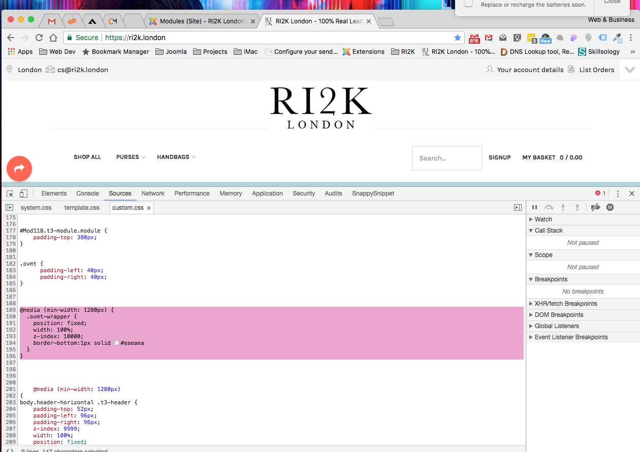

February 6, 2018 at 2:27 pm #1090365Ok great thats working thanks!
One thing that I’m trying to do now though is make to sticky/fixed at the same pixels my normal menu is!
I’ve tried to copy the same code that makes my Main Menu sticky down to 1280px but the new toolbar I’ve added it this topbar position doesn’t work – please see the live page here: https://ri2k.london/my-account
@media (max-width: 1280px)
.ovmt-wrapper {
padding-left: 96px;
padding-right: 96px;
z-index: 9999;
width: 100%;
position: fixed;
background: #ffffff;
border-bottom:1px solid #eaeaea}
Saguaros ModeratorSaguaros
February 7, 2018 at 2:32 am #1090490You can try this tweak:
@media (min-width: your_desired_width_here) { .ovmt-wrapper { position: fixed; width: 100%; z-index: 10000; } }
