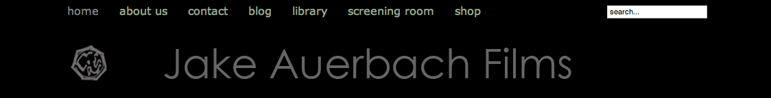

I am designing a site for a friend at http://www.jakeauerbachfilms.com
He would like me to put the search box in the top right hand corner, in line with the top nave. I have looked with firebug and the main nav goes right across the whole of the screen. Please could someone tell me if I can do this, and if so, in simple terms how.

Thanks you very much.</blockquote>Hi
Is this what you want?
If so you need to make some adjustments in your file templates/ja_t3_blank/css/template.css. Add this code to the bottom of the file…..
.wrap {background: none;
#ja-search {bottom: 100px; < play with this number to get how you want-100 is just an idea
position: absolute;
right: 0;
}Hope that helps!

June 19, 2012 at 6:43 pm #458090Thanks a million!!! That sorted it.
