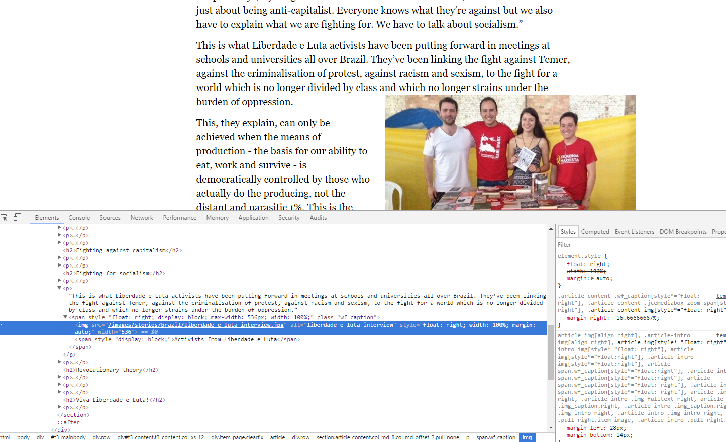

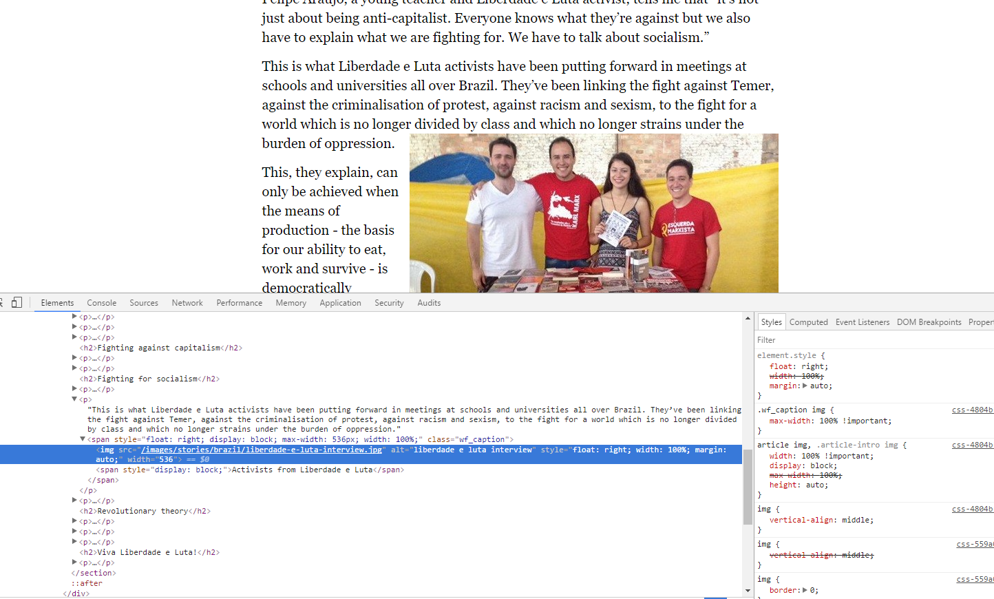

April 21, 2017 at 12:58 pm #1027981Hi,
Sorry for not making myself clear. I originally thought the problem was with less compiler but I now realized it’s the css compression (minify) that does it.
See the difference in these two images. One with optimize css on, one with off.
The difference in the css that is generated is as I explained above. The blank space in the style attribute css selector is removed:
article span.wf_caption[style*="float: right"], article span.wf_caption[style*="float:right"],
and turned into
article span.wf_caption[style*="float:right"], article span.wf_caption[style*="float:right"],
meaning, it will not match
<article><span class="wf_caption" style="float: right"></span></article>
but only match
<article><span class="wf_caption" style="float:right"></span></article>
Is that clearer?
It’s a problem where the css optimizer removes what it perceives as unnecessary blank spaces, which are actually needed.
Niklas
