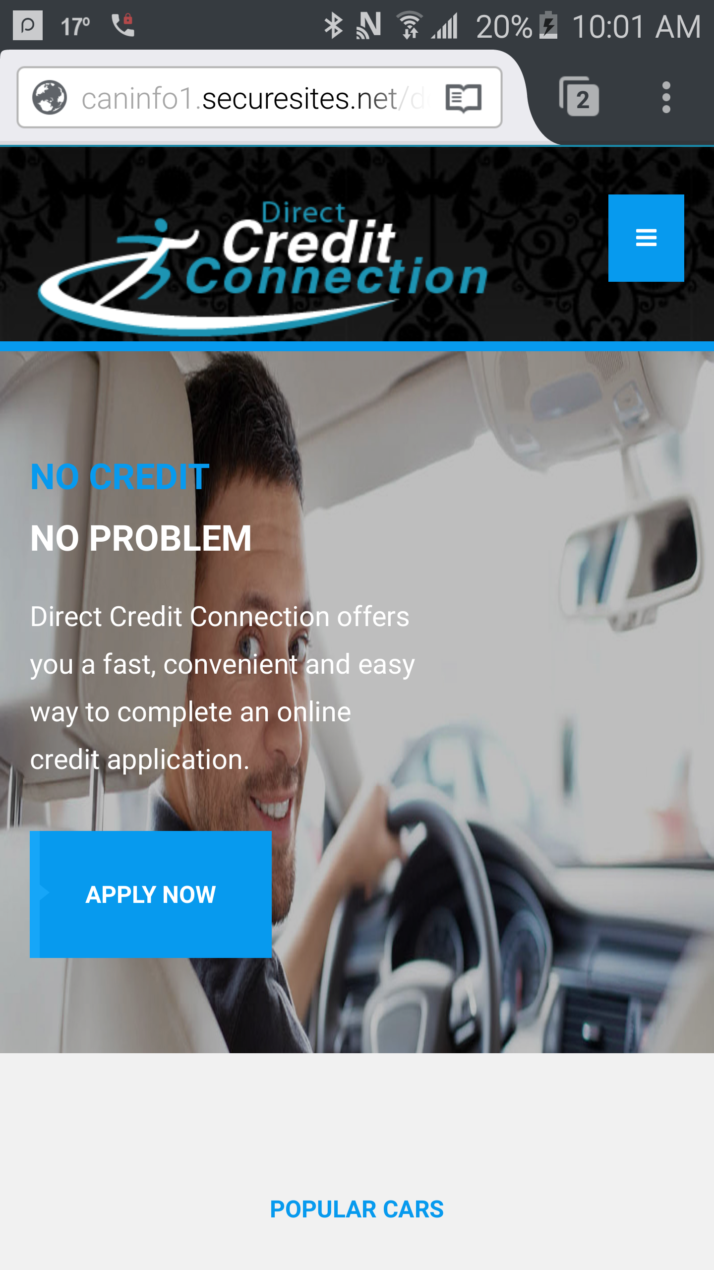

becuase u have addded the code in style.css its using the style from it . If u will remove it from style.css it will pick the code of custom.css : http://prntscr.com/bk9lgvJune 24, 2016 at 5:51 pm #943968Thank you that did work. I also found another problem with the slideshow. The aspect ratio is not scaling the image slideshow correctly when viewed on the phone. It would seem that min-height might have to be adjusted to fix this, but I am not sure where to go to adjust this css value.

Pankaj Sharma ModeratorPankaj Sharma
June 25, 2016 at 1:52 am #944002Hi
Images are using 100% width and height of image .
Here u can see this : http://prntscr.com/bkq31h Its resized as per the original size of the image aspect ratio.June 25, 2016 at 5:10 pm #944110As you can see from the 2 attachments I have included the aspect ratio of the 2 screen captures are different. The narrow screen capture has the wrong aspect ratio.

June 27, 2016 at 3:10 am #944393Hi
Aspect ratio change with respect to the container size , because the screen size reduced and narrow in mobiles the image also resize according to it .http://prntscr.com/bkq31h
You can add below code in custom.css file to make the height auto so it can fit in screen@media (max-width:468px) {.acm-slideshow .owl-carousel .item .slider-img { width: 100%; height: auto!important; }}
But in that case u have blank space below because of the item content height .
