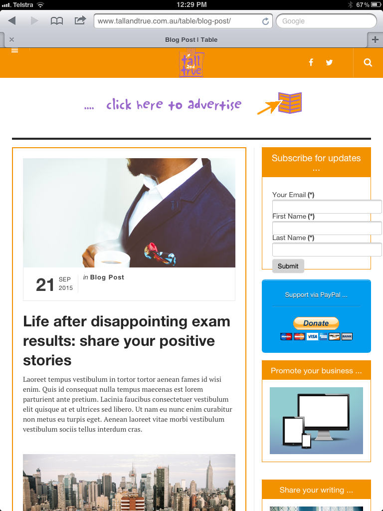

June 6, 2017 at 2:39 am #1039785With all due respect, I am testing the website on real devices. Attached is a screenshot showing the problem with the Blog page on an iPad.
The "Subscribe for updates" and other sidebar-2 modules sit underneath the main content on the Home page and other menu options, and for the articles.
I will tweak the CSS setting for the width of the text box as suggested, but I would have thought the width would apply to the Blog and Home pages etc, and the articles?
Regards, Robertf

June 6, 2017 at 5:44 am #1039855Okay, thanks, so how do I change the output style so that when the Blog page screen size is between 992px and 766px it looks like the Homepage and Article pages, with the sidebar-2 modules displayed under the main content?
I’ve tried changing the LESS variables and this had no effect and I can’t find the code or CSS that’s specific for the Blog pages.
Regards, Robertf
Pankaj Sharma ModeratorPankaj Sharma
June 6, 2017 at 7:13 am #1039882Hi
Use below code in custom.css file@media (max-width:992px) and (min-width:466px) { .itemid-136 .formResponsive input { width: 170px; }}
Hope it helps.

June 7, 2017 at 4:36 am #1040177Thanks Pankaj, your CSS code fixed the Blog page formatting problem.
