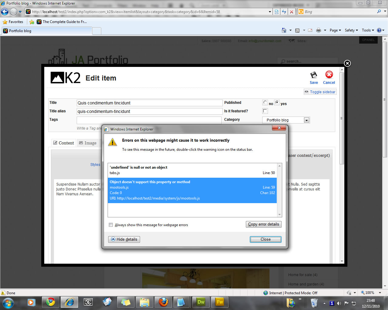

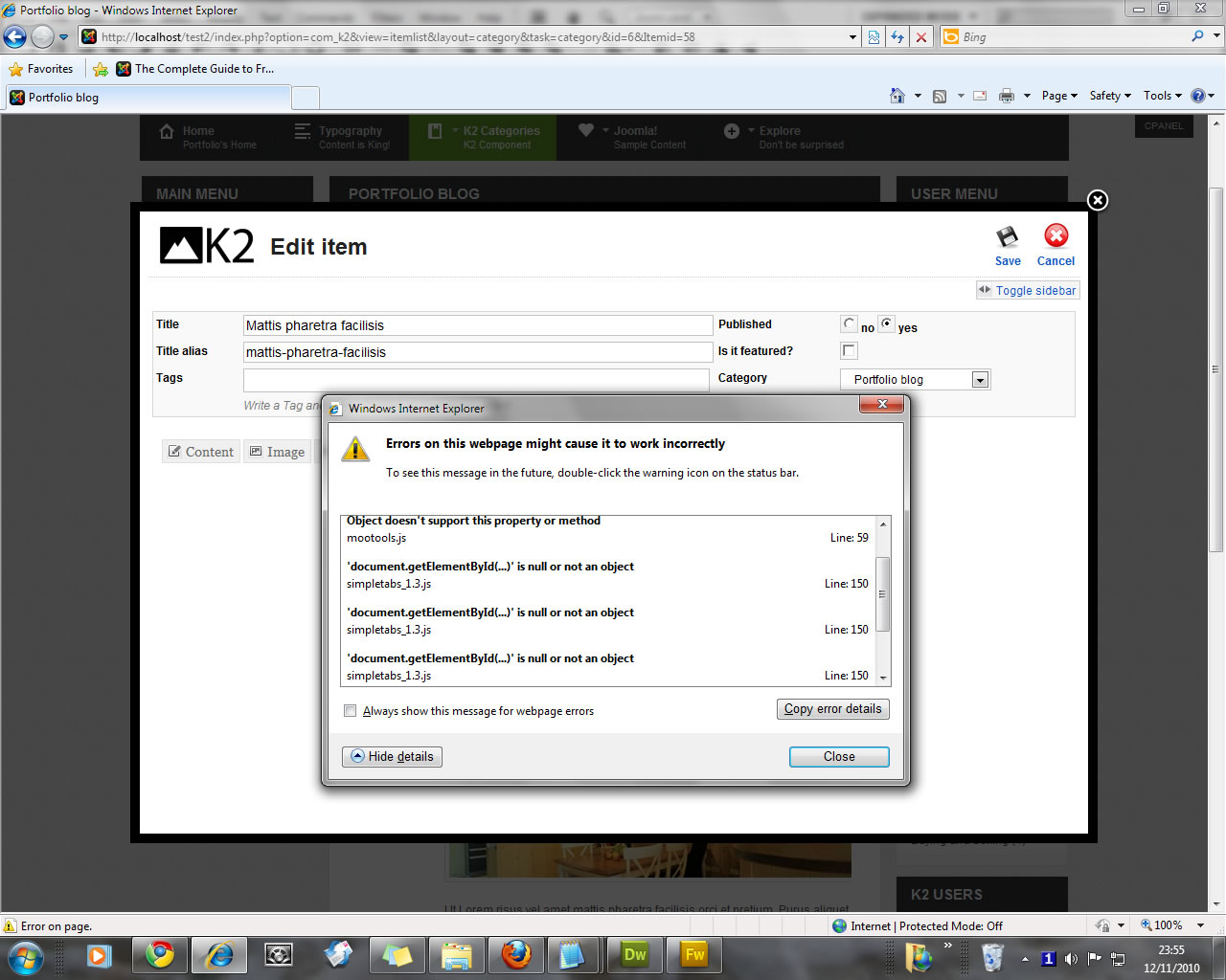

November 10, 2010 at 11:08 am #156270There is a javascript conflict with the K2 component which is preventing front end editing or adding an item, have spent the last week trying to get this to work on a live site and ended up installing the quickstart package to see if the error was there too and it is:
<blockquote>
Webpage error detailsUser Agent: Mozilla/4.0 (compatible; MSIE 8.0; Windows NT 6.1; WOW64; Trident/4.0; SLCC2; .NET CLR 2.0.50727; .NET CLR 3.5.30729; .NET CLR 3.0.30729; Media Center PC 6.0; InfoPath.2; .NET4.0C; .NET4.0E)
Timestamp: Wed, 10 Nov 2010 10:54:11 UTCMessage: ‘document.getElementById(…)’ is null or not an object
Line: 150
Char: 3
Code: 0
URI: /administrator/components/com_k2/lib/simpletabs_1.3.js</blockquote>This is stopping the K2 tabs on the front end edit item and add now item from working. The error is there with Portfolio set in development mode with no caching or script compression. If you switch to any of the default templates – rhuk_milkyway, beez or JA_Purity there are no errors so the conflict is with something in JA Portfolio. I thought Portfolio was designed to work with K2?

November 10, 2010 at 11:26 am #362283Also if the user closes the editing window by clicking the X this error occurs:
<blockquote>Webpage error details
Timestamp: Wed, 10 Nov 2010 11:25:06 UTCMessage: Can’t execute code from a freed script
Line: 1
Char: 32179
Code: 0
URI: /plugins/system/mtupgrade/mootools.js
</blockquote>Saguaros ModeratorSaguaros

November 13, 2010 at 10:22 am #362725Words fail me, I am completely stunned that no one has bothered to read the support tickets properly. Below is the current error that you left me with this morning!!
What part of login in from the front end using IE8 and try submitting or editing an article via K2 did no one get?<blockquote>Webpage error details
Timestamp: Sat, 13 Nov 2010 09:50:35 UTCMessage: ‘undefined’ is null or not an object
Line: 381
Char: 153
Code: 0
URI: blogs/item/add?tmpl=componentMessage: Object doesn’t support this property or method
Line: 59
Char: 102
Code: 0
URI: media/system/js/mootools.js</blockquote>Please note that the error occurs with or with out the Mootools upgrade plugin enabled the only thing that changes about the error is the path to mootools!! Which incidentally is essential for the running of my site and I was not impressed to find that you had switched it off!
The template is advertised as being compatible with K2 but it isn’t as users can’t submit articles using Internet Explorer!!

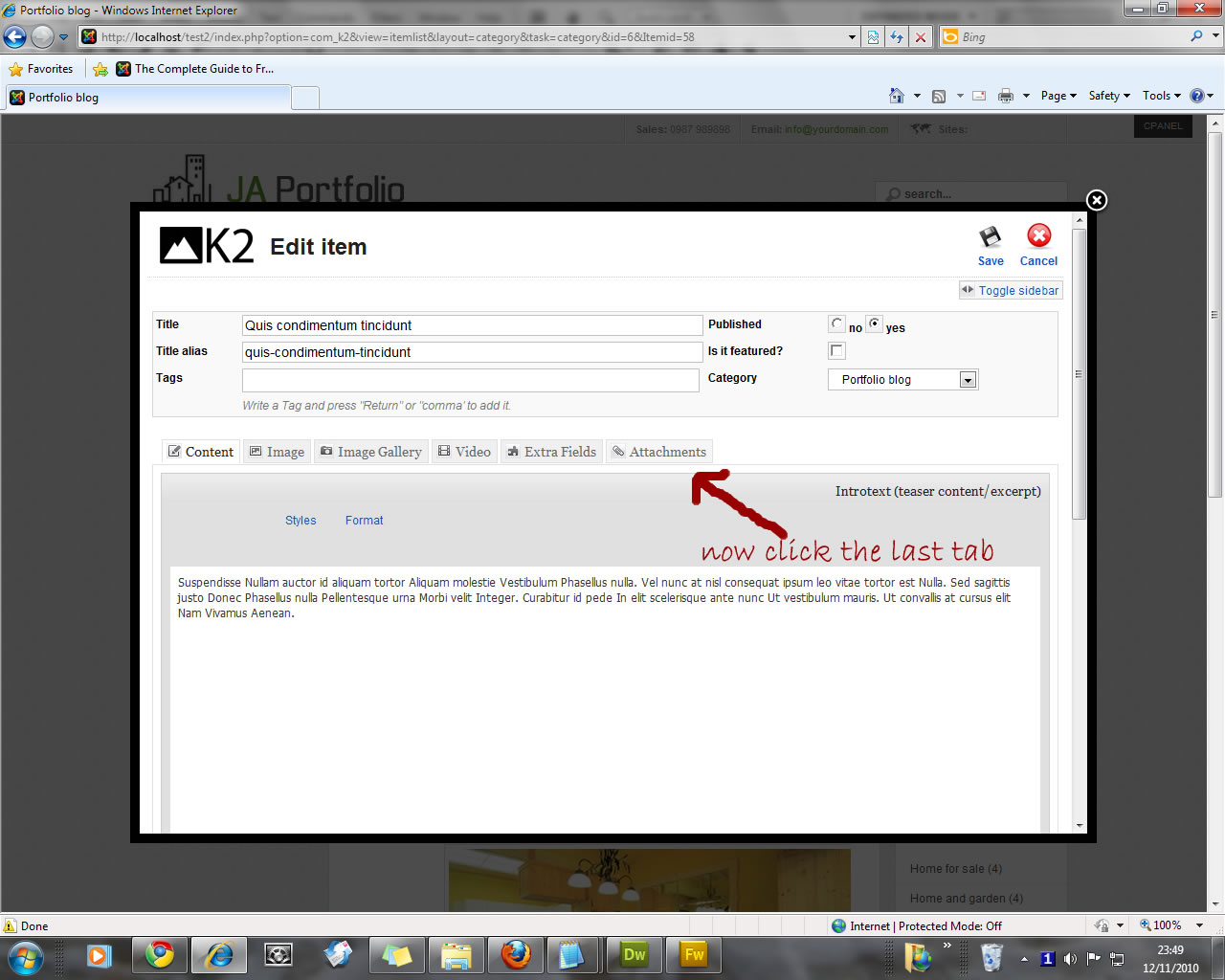

For the last time please install any of the quick start pages on your webspace and login in to the front end using Internet Explorer and try to edit or add an article to K2 via the front end and you will clearly see the errors and will have extreme difficulty using the tabs on the edit form.
I even sent screenshots from the quickstart package, I can’t believe you still got it wrong.

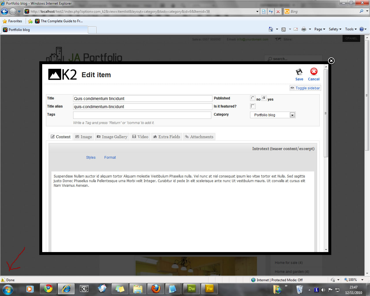

I’ve attached the screen shots that I sent when I submitted the ticked they are taken from a virgin install of the JA Portfolio quick start package (latest release). Please look at them carefully.
Front end user tries to add an item to K2- Phill Moderator

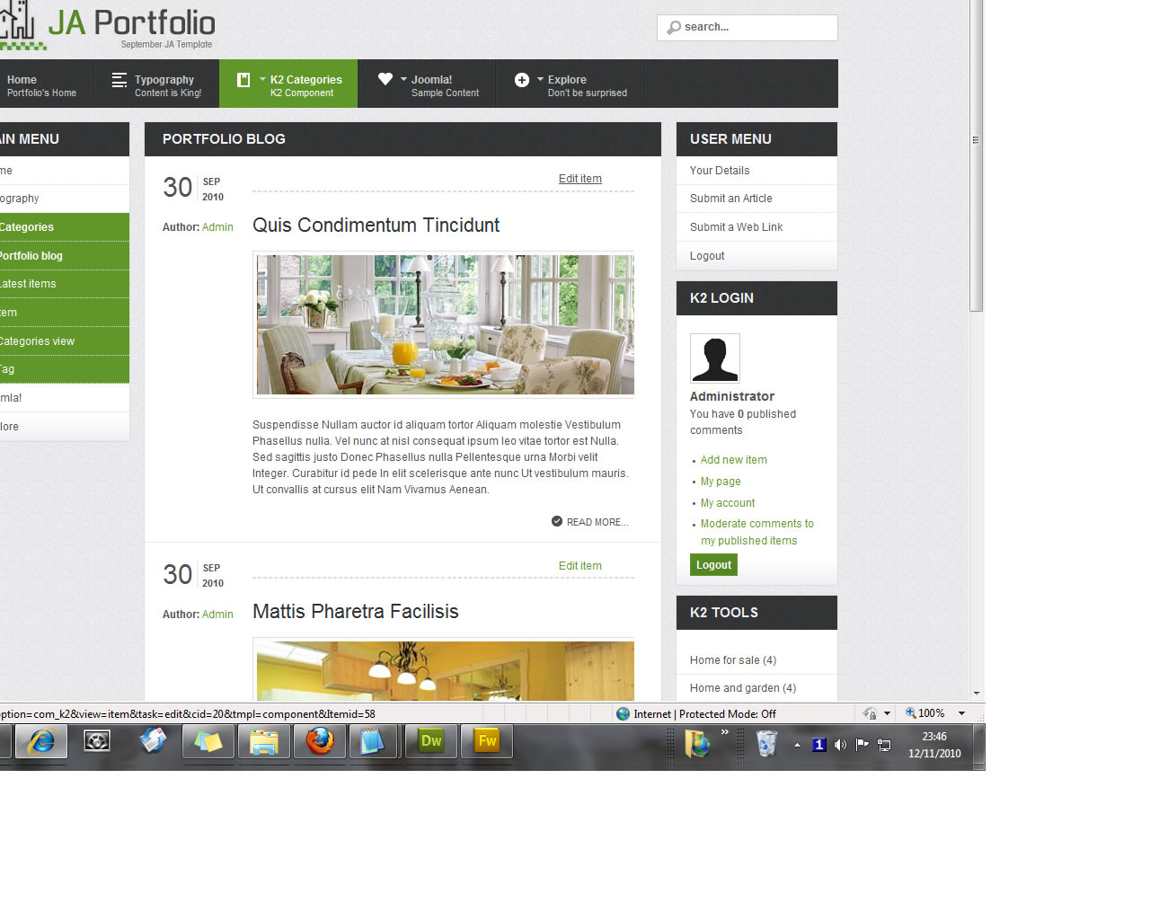

November 13, 2010 at 1:02 pm #362742Steps needed to replicate this bug.
1 – Install the template quickstart.
2 – Go into the usergroups panel of K2 and in the registered group enable front end editing.
3 – Logon to the site from the frontend
4 – Go to any K2 article and press the edit button.In IE8 you will see a number of js errors depending on what you do. In FF various problems occur.
