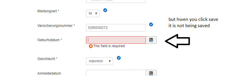

  • birthday field is not beeing saved.

      #4- Birthday field is fixed, kindly check.
      thank you.
      what was the problem?

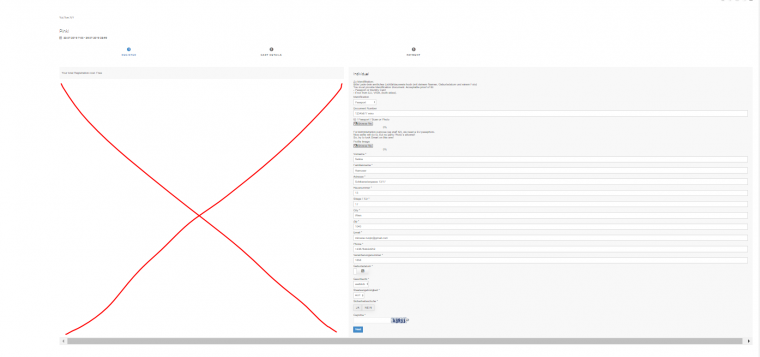

      "Your total Registration cost: Free"
      How to remove the whole left part at free events?
      i need a answer to my earlier questions:
      this is your demo page
      where is this text coming from: Blue question mark
      where is this redline coming from and what deos it does?

          #4 Birthday field is fixed . Issue is with date string validation with date formatting .

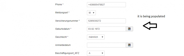

            no.it is not fixed
            it is being populated, but not saved.
            You must go into the field and click to work, otherwise it will not save the registration.

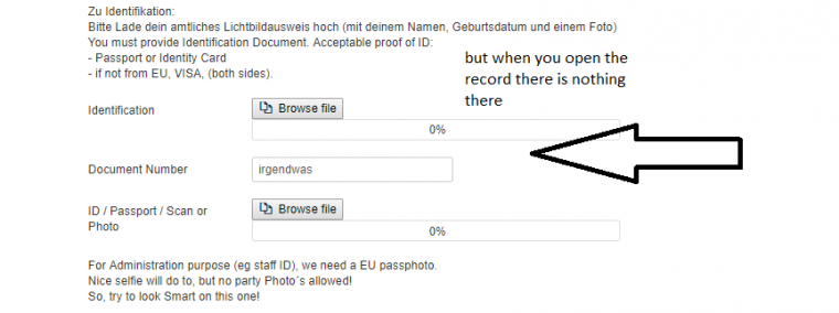

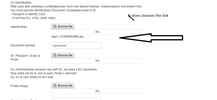

            #1- Could you clarify this issue in more details so I can check?
            Fixed (code changes needed for new look form), One issue on your mapping is Dropdown field mapped to cb field of type "file" .
            no. it is not fixed
            gslitt91
            imagine, you are usig a dt register for a classes, workshops, ... and you need you user to upload their id every time again and again, and again, and again, and again.......
            you see... not cool
            if this is my mistake pls help me understand it and fix it, but i dont think so..

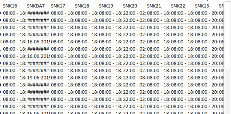

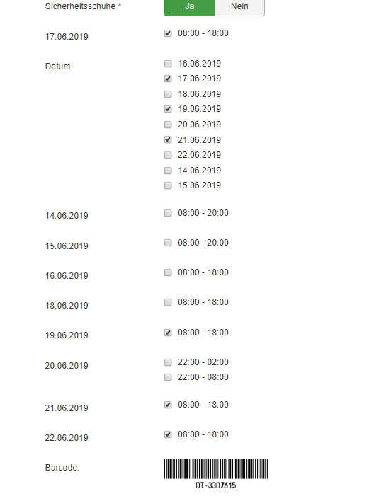

              CSV is not fixed
              i am having users in one event choosing some radio & checkbox fields (option 1, option 2, option 3, option 4...)
              and the choose different options somethimes 1,3,4 | somethimes 1,2,4...)
              but when exported, they all have all the option in the csv file.

                  another thing
                  for free events there must be the possibility to remove the left column as this only brings in the confusion within the registration porocess if you are using dtreg for free events,
                  - > you could insert this as a option in event configurations: "show/don't show cart for free events" or something like that, this would then simply show/not show Registrations cost and payments and like...
