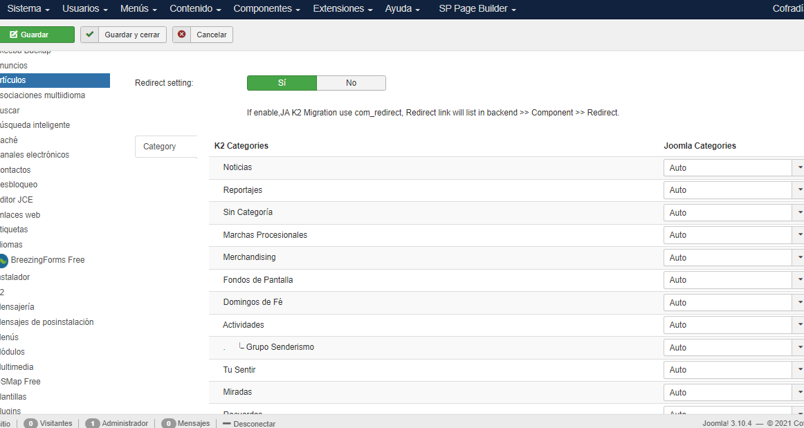

Hi, I have purchased plugin A K2 to com_content migration but can't get it to work.
First of all inform that my version of joomla is 3.10 and from the backend it does not look correctly, since things are missing.
I have read the documentation and it says it is compatible with joomla 3.
Could you help me??
I am attaching a screenshot.
Thanks a lot

Hi, I don't know how but I have discovered that your plugin has worked.
After much research, the migration options have appeared elsewhere on the backend.
The migration was successful, although the plugin design is not good.
the options appear elsewhere in the article manager.
Still thank you very much for your help.
Attached screenshot so you can see it.
