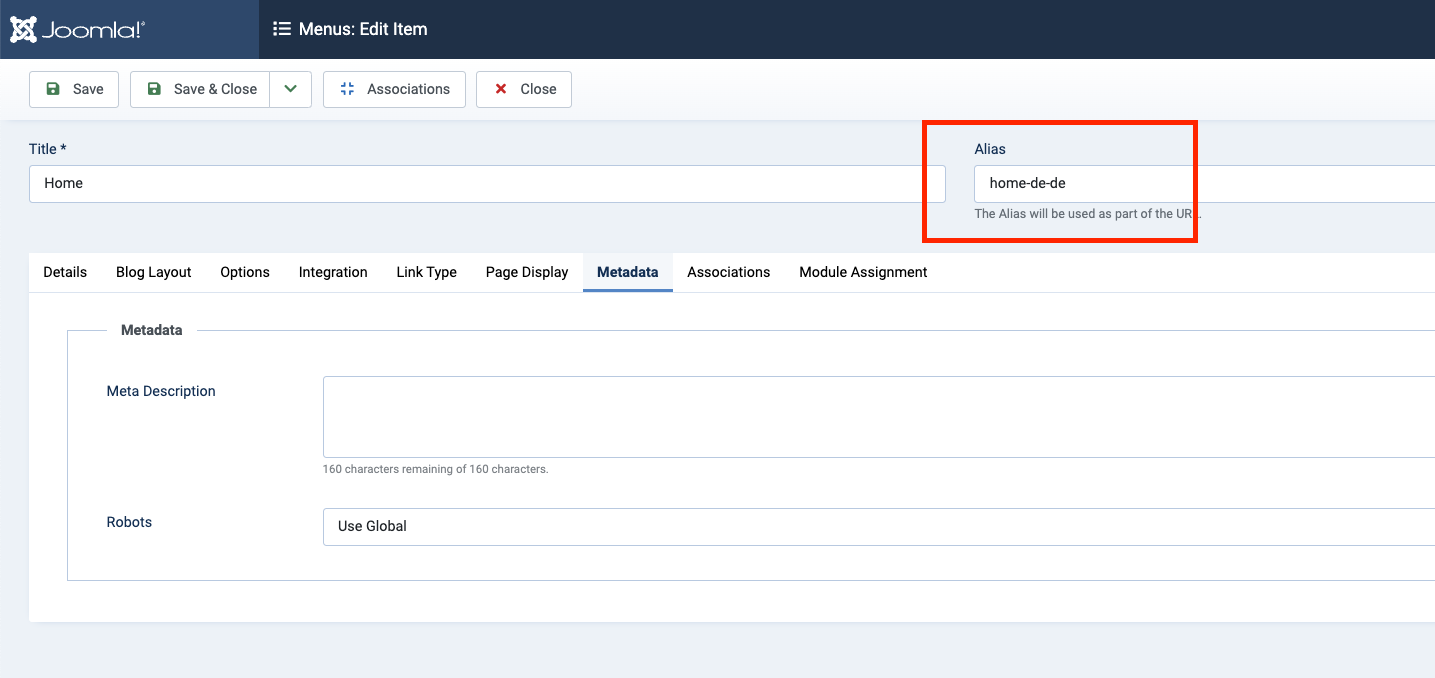

            I tried to run the translation in a Joomla fresh website with German and it worked properly:
            You can try switch to older PHP version instead of v8.2 and disable 3rd party extensions on your site as it may cause conflict.
            Otherwise, there must be something wrong with Joomla on your site.
