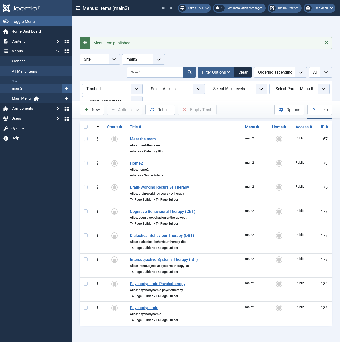

      Ok, getting there... BUT, every time I try and save a page to a menu it defaults to trashed? please tell me why
      ? seems to be an issue with menu saving on T4.
      Appreciate your attention to this asap. Thanks
      I think something wrong with the database and Joomla on your site, not T4 Builder.
      For example, the home menu item of your site: Meet the team << this is Category Blog page - a Joomla page but I can't publish it.
      I totally disagree with you here, please try yourself to publish an article from T4 page builder to a menu - and default that to Home - it immediatly goes to trash. I have never encountered any issues at all like this and only since I purchased T4 builder has this caused massive problems, Sorry but I do expect a bit more help here!
      Joola db is up to date and on the latest version!
      so why are all these T4 pages not saving to a menu!!!!
