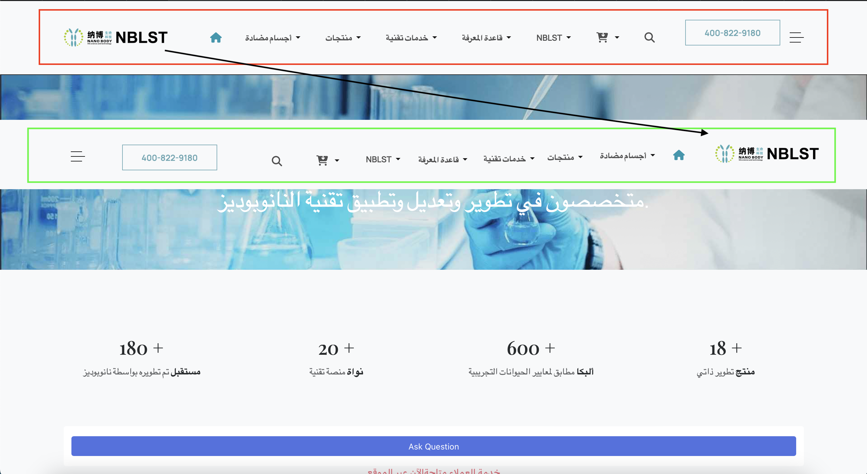

    The page layout is still displaying from left to right when Arabic language is selected. It should change to right-to-left direction for the entire page. I have attached a screenshot and added a finger gesture indicating how the page layout should appear after choosing Arabic language.

                Please turn off plugin System - Metaman and try to switch language again.
                I appreciate your assistance with this issue. It's working well now. Thank you so much!
