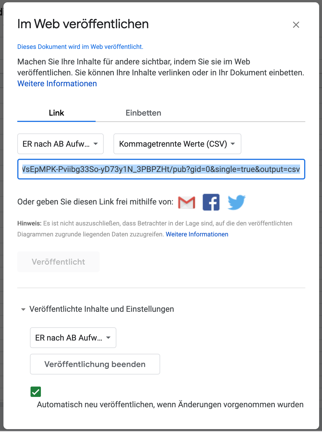

          Could you share screenshot highlighting the dialog you're mentioning? I followed our documentation and applied the same for my above link.
          Hi, yes of course!
          Here you are
          anything else we can do for you? Maybe share the table with your Google-Account (please let us know your G Suite Gmail address).
          Thank you, S.
            seppali
            I don't understand the issue here, this dialog is from Google and yes, it changed recently but the link should still work and I did the same steps with above link.
