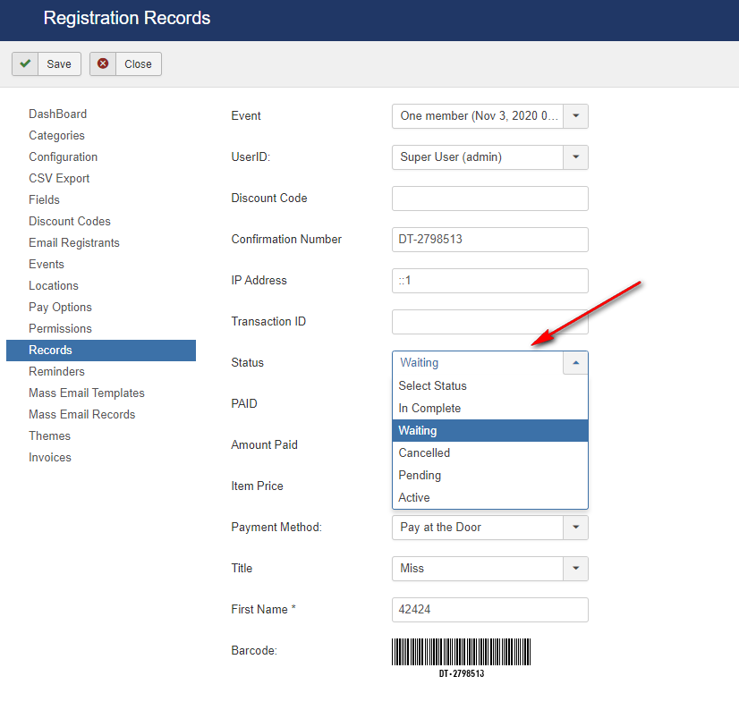

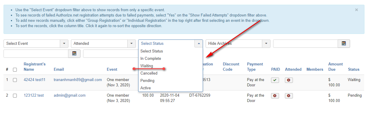

                      I mean, you can open user Record at administrator/index.php?option=com_dtregister&controller=user
                      On filter bar, select status Waiting then edit record that you see.
                      Change status or record from Waiting to anything you want.
